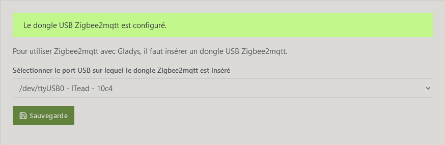

It’s only the display; if you look in the Zigbee2mqtt configuration file (in the folder /var/lib/gladysassistant/), you’ll see that the port is indeed the correct one :slight_smile:
We display the port + the « name » of the connected device so it’s more readable for a regular user, otherwise it would be indistinguishable from the other USB ports.

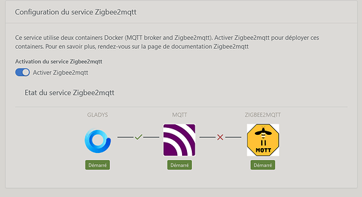

Curious, to test I removed my ConBee II key which works very well on my other Beelink BT3 Pro2 Jeedom setup, so if I refresh the key in the interface it is seen but still the same: no MQTT link to Zigbee and in the configuration.yaml file the « port » parameter of the « serial » section is « /dev/serial/ttyUSB0 »
after a reboot this becomes « /dev/serial/ttyACM0 » so the parameter doesn’t change when you enable/disable the services via the dashboard / integration/ zigbee2mqtt (by the way why is stopping the MQTT docker tied to that of zigbee2mqtt? I understand starting it, but not stopping!)
ls -l /dev/serial/by-id/ returns:
usb-dresden_elektronik_ingenieurtechnik_GmbH_ConBee_II_DE2665658-if00 → ../../ttyACM0
and still the same so honestly I don’t understand that the keys are detected but the zigbee2mqtt container keeps rebooting (every 30s)

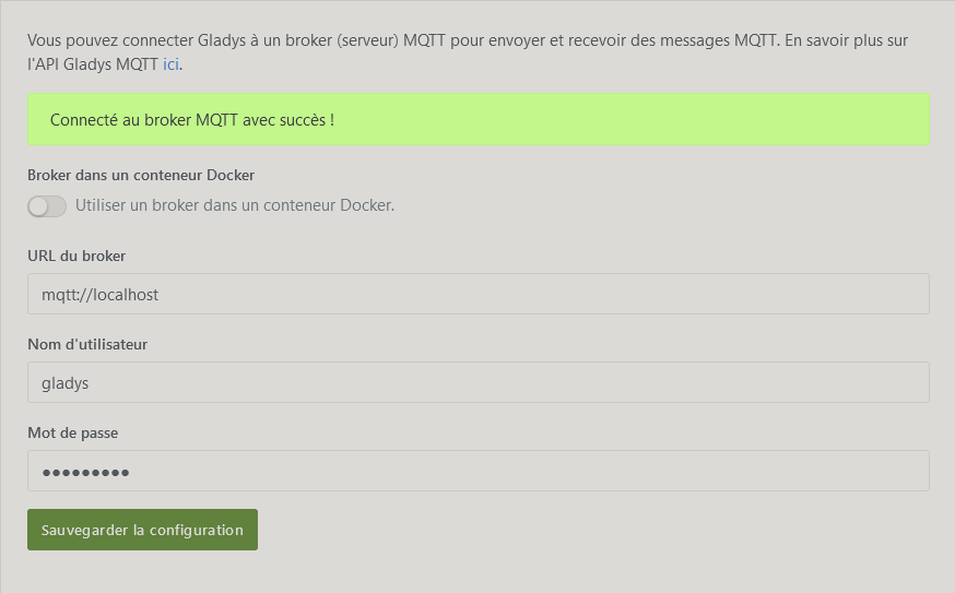

I enable « use a broker… » and it tells me « connected successfully » still without the mosquitto container nor zigbee — there’s a bug, to put it bluntly, a real mess!!!
I stop the gladys container then start it, it reloads the images but still the same: no connection and the zigbee container reboots every 30s

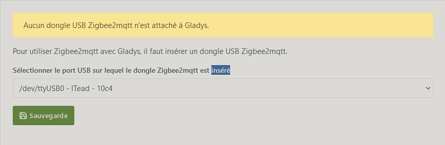

I stop the Beelink, I put the Sonoff dongle back and restart the Beelink
it detects it but can’t bind the dongle to Gladys
after 2 minutes it’s configured

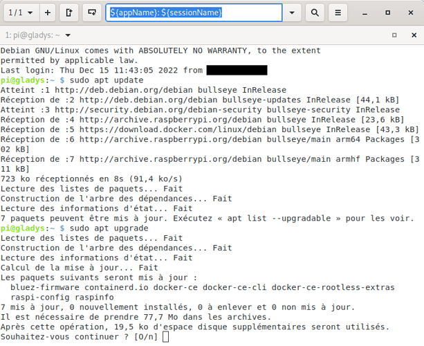

@cce66 If you have SSH access
ssh pi@xxx.xxx.x.xx
x being the Raspberry’s IP address
You can try a
sudo apt update
then
sudo apt upgrade
You never know.
Well maybe not to do it right away — I’ve been stuck at 97% of the installation for 10 minutes.
An update + upgrade + reboot should be done at regular intervals to pick up all the patches, including security fixes.

Well, I’m still at 97%; I think I’m going to have an issue.
Edit: Manual reboot of the Pi — everything installed fine, I had probably lost the SSH connection.
@bjm is right, no dist-upgrade. Especially when a new version has just been released.
On the Raspbian images security updates are automatic. You can do a regular upgrade of the packages but don’t forget that it’s your home automation, so if a package fails or the kernel is unstable — Hasta la vista, the connected house. (generally it’s not blocking but it’s a pain :sweat_smile:)
And rebooting is only necessary in case of a kernel update.

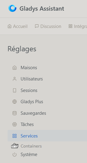

@pierre-gilles Crazy thing, I plug in a 2nd Sonoff key and reassign in Gladys to the 2nd then the 1st and I don’t know why that must have changed something in the zigbee2mqtt container because since then the connection is made even after removing the 2nd key. However in Gladys removing the 1st key afterwards does not change the container’s state in Gladys even though a docker ps -a shows it as exited :thinking: — remains to be seen how long it will keep running? So this is indeed a problem with the zigbee2mqtt container more than anything else, even if Gladys should improve container management (reflect the state even though we have it in System: stop, start, restart, remove, remove image, reload image) — why not integrate it into the Settings section above System? Well, since my Raspberry’s SD card burned out I can’t run the test but I’ll try as soon as possible!
I agree that the Z2M integration in Gladys has trouble with state changes and that it could use some improvement! :slight_smile:
But as you say, that’s not the core of the problem here — there’s clearly another issue coming from Z2M itself.
