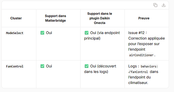

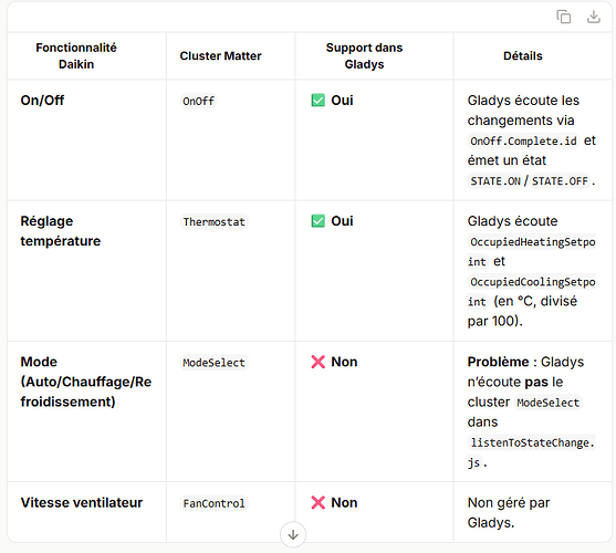

Here’s a brief summary by AI between the features of Gladys and Matterbridge:
@pierre-gilles I’m unfortunately at the limit of my knowledge to make this compatible.
Do you think you might have a bit of time to take a look?
Thanks
So the situation has evolved since then, as the FanControl cluster is now managed by Gladys! (But no one had tested the development, so we’re iterating on this topic: Matter : Investigation ventilateur Dyson Matterbridge )
For ModeSelect, I can take care of it yes
