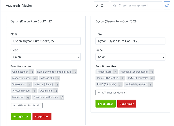

However, I see ‹ Add to Gladys › even though the services already exist and have the exact same name.
When I click on Add, it updates device 28 with the NO2 (and therefore not a new service) but I can’t do the same for 27, nothing happens.

Regarding the Matter device, there is no update button, only an add button.
And when I click on add, nothing happens and nothing in the logs

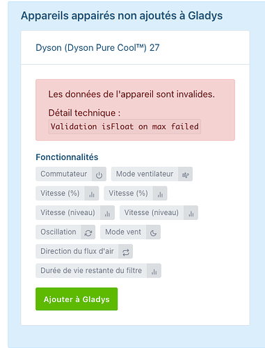

@mutmut @Nagromdark Ok, I’ve modified the frontend to display the error more explicitly. This change will be included in the next version of Gladys Assistant :slight_smile:
In the meantime, as this is a purely frontend change, we can already test it via a Gladys Plus test URL (available immediately) here: https://display-matter-save-error-in.gladys-plus.pages.dev
Can you test and give me the error?

Thanks for testing. Good, but the screenshot doesn’t help me much, so I’ve added more information to the interface to get more data!
Can you re-test on: https://display-matter-save-error-in.gladys-plus.pages.dev/ ?
No need to send me the server logs, the error message is purely frontend!
Thanks :slight_smile:

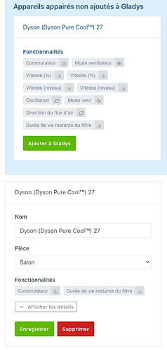

I still have Add to Gladys instead of Update:
but the « addition » works fine (no more errors) and replaces the old one:

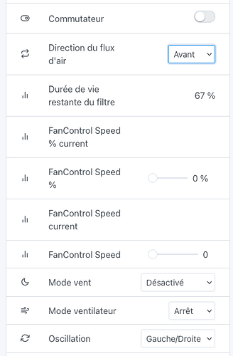

and as expected, it deleted the old commands from the dashboard (with a small text issue):

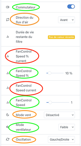

Once the dashboard is reconfigured, for what works and what doesn’t (wrong Matter handling or plugin?): green → 100% operational, orange → not 100%, red → no action/info

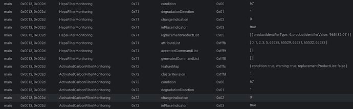

  • filter life duration hasn’t changed recently so I guess it’s normal (I should have 67% today):
  • the speed current values are not retrieved even though they are present in matterbridge:
  • the air flow direction is retrieved but doesn’t control anything
  • Fan Mode is retrieved (Disabled or Night Vent only) but no action
  • Oscillation correctly controls Disabled and does nothing when selecting Left/Right, but it does retrieve the correct fan state value. For info, on my TP04 I have several oscillation angles (0° or Off, 45°, 90°, 180°, 350°)

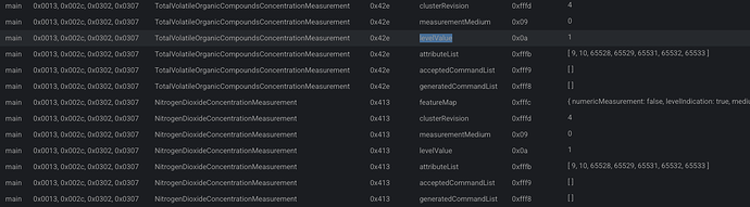

For the air quality part:
NO2 and VOC may not have changed recently but they do have values (levelValue):
However, I don’t have the AQI in Gladys but it is present in matterbridge:
Thanks for all these ultra-precise feedback, it helps me a lot! :folded_hands:
Actually, I had confused: in the current Matter integration, there was only one button « Add to Gladys ». We didn’t have a translation variant for the case of an update.
I modified the interface to display « Update », to be consistent with the behavior of Zigbee2mqtt.
and as expected it deleted the old commands from the dashboard (with a small text issue in the process)
Thanks for the feedback! It was indeed a bug in the Matter integration: the selector of the features changed between two additions, which broke existing dashboards and scenes.
It’s now fixed. :white_check_mark:
Once the dashboard reconfigured, what works and what doesn’t work
I made corrections on all the points raised. Thanks again for this very detailed feedback, it’s really precious! :raising_hands:
filter life duration hasn’t changed recently so normal I would say
I added an initialization at startup to avoid having empty values on the dashboard.
However, I don’t have the AQI in Gladys but present in matterbridge
It wasn’t part of the scope of this development. :slightly_smiling_face:

And for the tests:
  • flow direction: functional command!
  • wind mode Disabled and Night Wind: functional command!
  • oscillation Disabled and Left/Right: functional command!
A small remark about Wind mode:
When I’m in Night Wind and switch to Disabled, it works (but you shouldn’t change too quickly otherwise the action is not taken into account).
If I go to Natural Wind after Night Wind, it changes correctly and then switches back to Disabled, which is normal because it’s either normal or night.
And if I choose Night Wind + Natural after Disabled, it switches back to night mode.
In fact, it only keeps 2 states: Disabled and Night Wind.
Is there a way to change and have only that?
Otherwise, well done @pierre-gilles, for me it’s all good :slight_smile:
Awesome, so cool if it works now!
Gladys strictly follows the Matter specification, and according to what the Matterbridge-Dyson plugin exposes, it seems to support all 4 modes.
To be more faithful to the expected behavior on the Matter side, it would probably be necessary to adjust the Matterbridge-Dyson plugin :slightly_smiling_face:
