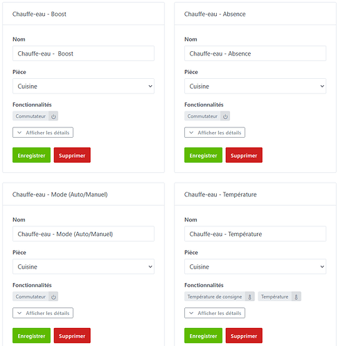

I then added the different elements via the matter plugin of Gladys:
And I added them to the dashboard:
As you can see, the water temperature does not seem to be displayedHowever, no issues with the switches after the first activation/deactivation via Gladys, the sync with the app works very well.
Do you have any idea about the water temperature that comes up in matterbridge but not on Gladys? Or even a debugging tip? :slight_smile:
Note that the water temperature doesn’t even appear on the cozytouch app
PS: I intentionally disabled the setpoint temperature as it is not adjustable on my device :face_with_raised_eyebrow:

Can you download the Matter JSON nodes file that is in the Matter integration settings on Gladys’ side?
This will already allow us to see which Matter clusters are exposed, and therefore to see if any are missing in Gladys!

Hello the plugin was made on my side for my hot water balloon and I indeed had a problem with the feedback. I didn’t have time to dive back into it

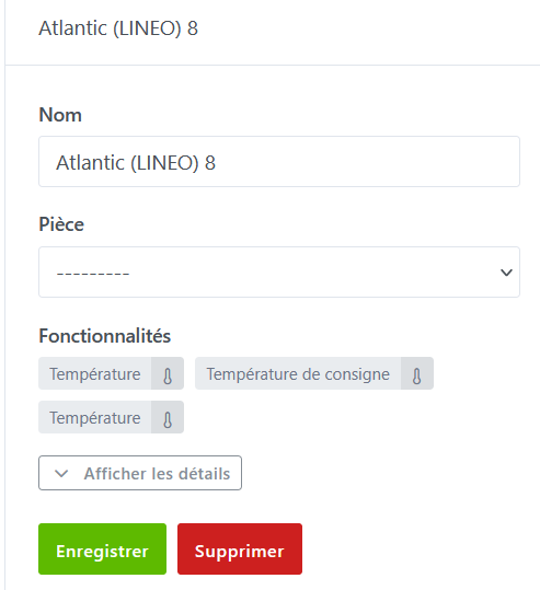

I just tested it on my test environment and I have another temperature that appeared but apparently it’s still the same issue:
I’m sending you the json file in PM :slight_smile:

But I don’t know why I have the info twice :sweat_smile:
Content that it works! :slight_smile:
The temperature is doubled because the Cozytouch Matterbridge plugin exposes the same value via two clusters (TemperatureMeasurement (cluster 1026) and Thermostat.localTemperature (cluster 513)).
Gladys displays both if you’ve added them to the dashboard.
Why do both exist in Matter?
Matter separates functional role and device type:
  • Thermostat: Device that regulates (water heater, radiator, air conditioning
  • TemperatureMeasurement: Passive sensor (room probe, water probe
So the solution, if it’s not useful, would be to modify the Cozytouch plugin to expose only one of the two clusters :slight_smile:
But in any case, on the Gladys side, it’s important to manage both types of clusters!

Ok I understand better, thanks :slight_smile:
We won’t modify the Cozytouch plugin :sweat_smile: and I’ll ignore one of the two values
