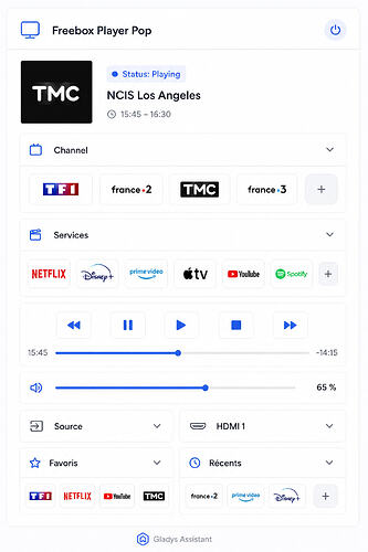

Hi @pierre-gilles,
I’ve looked around a bit, and it’s mainly at HA that we have leads…
So, I see three possible approaches:
  1. A single widget that automatically adapts to the device’s features (channels, apps, remote, volume, etc.).
  2. Several specialized widgets depending on the type of player (audio, video, casting…).
This is HA’s choice if I understand correctly
  1. An adaptive version, lightweight on mobile and more complete on desktop.
Personally, I like the first one…
Quick question, I don’t have a Sonos at home but did I understand correctly:
  • The existing music widget is only for Sonos?
  • Gladys already sees existing Sonos groups, but doesn’t allow creating or modifying them???
Base: 4 Matter clusters (OnOff, MediaPlayback, LevelControl, KeypadInput)
List of features for a « universal » media widget identified so far:
:bullseye: CORE FUNCTIONS (All Devices)
Playback Control
✅ play() - Start playback
✅ pause() - Pause
✅ stop() - Stop
✅ next() - Next song/program
✅ previous() - Previous song/program
Timeline / Progress
✅ seek(position) - Jump to a position
✅ displayTimeline() - Display progress bar
✅ displayTimeElapsed() - Display elapsed time (15:45)
✅ displayTimeRemaining() - Display remaining time (-14:15)
Volume Control
✅ setVolume(0-100) - Set volume
✅ increaseVolume() - Increase volume
✅ decreaseVolume() - Decrease volume
✅ mute() - Mute
✅ unmute() - Unmute
✅ displayVolumeLevel() - Display volume %
Power Management
✅ powerOn() - Turn on the device
✅ powerOff() - Turn off the device
✅ togglePower() - Toggle on/off
✅ displayPowerStatus() - Display power status
Device Info
✅ displayDeviceName() - Display device name
✅ displayStatus() - Display status (Playing, Paused, Stopped)
✅ displayCurrentSource() - Display current source
:musical_note: AUDIO PLAYER FUNCTIONS (Yoto, Sonos, etc.)
Metadata Display
✅ displayArtwork() - Display album cover
✅ displayArtist() - Display artist name
✅ displayTitle() - Display song title
✅ displayAlbum() - Display album name
✅ displayDuration() - Display total duration
Optional Audio Features
✅ shuffle() - Shuffle mode
✅ repeat() - Repeat mode
✅ like() - Like the song (♥)
✅ dislike() - Dislike
✅ showQueue() - Display playback queue
:television: VIDEO PLAYER FUNCTIONS (Freebox Player, TV, etc.)
Video Display
✅ displayVideoOutput() - Display video
✅ displayThumbnail() - Display thumbnail
✅ displayChannelLogo() - Display channel logo
✅ displayProgramTitle() - Display program title
Video-Specific Controls
✅ fastForward() - Fast forward
✅ rewind() - Rewind
✅ frameByFrame() - Frame-by-frame advance
✅ subtitles() - Enable/disable subtitles
✅ audioTracks() - Change audio track
:television: TV CHANNELS FUNCTIONS
Channel Selection
✅ setChannel(channelId) - Change channel (TMC, TF1, etc.)
✅ displayCurrentChannel() - Display current channel
✅ displayChannelNumber() - Display number (34)
✅ displayChannelName() - Display name (TMC)
✅ displayChannelLogo() - Display logo
✅ nextChannel() - Next channel (+)
✅ previousChannel() - Previous channel (-)
Channel Quick Access
✅ renderQuickAccessButtons() - [TF1] [france2] [TMC] [france3]
✅ setFavoriteChannel(channelId) - Mark as favorite
✅ removeFavoriteChannel(channelId) - Remove from favorites
✅ showAllChannels() - Modal with all channels (62+)
✅ searchChannel(name) - Search for a channel
EPG (Electronic Program Guide)
✅ displayCurrentProgram() - Display current program
✅ displayProgramTitle() - Program title (NCIS Los Angeles)
✅ displayProgramTime() - Time (15:45 - 16:30)
✅ displayProgramDescription() - Program synopsis
✅ displayNextPrograms() - Display upcoming programs
✅ displayProgramDuration() - Program duration
:clapper_board: STREAMING SERVICES / APPS FUNCTIONS
Application Launcher
✅ launchApp(appId) - Launch an app (Netflix, Disney+, etc.)
✅ displayAvailableApps() - Display list of available apps
✅ displayCurrentApp() - Display current app
✅ closeApp() - Close the app
✅ switchApp(appId) - Switch to another app
Streaming Services
✅ launchNetflix()
✅ launchDisneyPlus()
✅ launchAmazonPrime()
✅ launchAppleTV()
✅ launchYouTube()
✅ launchSpotify()
✅ launchAllApps() - View all apps
