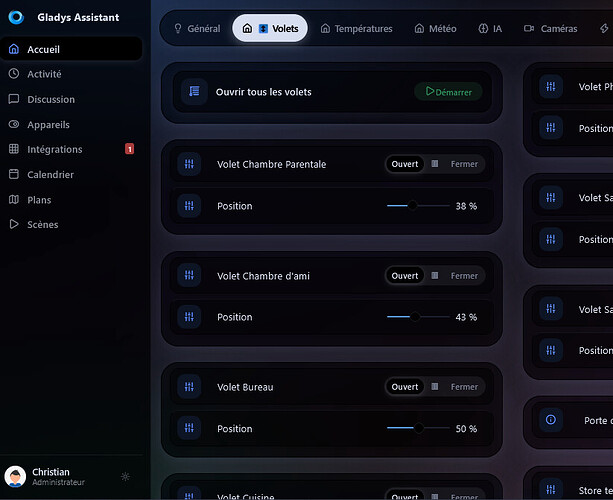

On PC and tablet, the left sidebar (Gladys menu) takes up space and reduces the useful display of widgets
It would be great to make it retractable like on mobile. The widgets would then take up the full width of the screen
