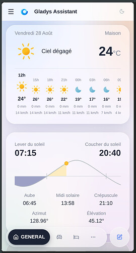

Some remarks about the navigation button at the bottom of the screen on mobile.
Here it is:
On the one hand, I think this large button would deserve a slightly more pronounced shadow in its upper part, as I sometimes have trouble distinguishing it from what is below

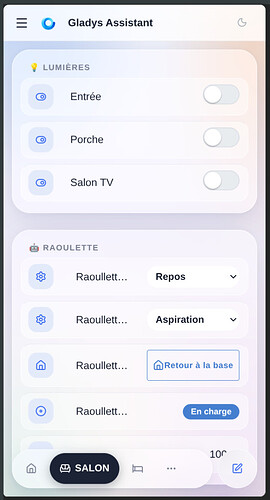

On the other hand, I would have loved to be able to slide laterally to scroll through the list of dashboards, because there the behavior is a bit shaky to my taste:
A click on my living room icon gives:

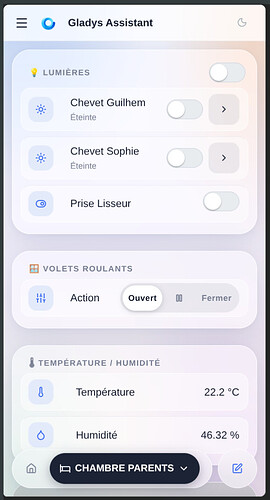

A click on my bedroom icon (right next to it) gives:
So already we have lost the icon with the « … » it looks weird.

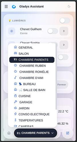

And when I click on the caret icon, I get this list which I find quite unattractive:
Especially since I have to scroll in this list.
Maybe it’s my abusive use of dashboards that leads to this behavior and that I don’t represent a classic use, but I wanted to raise this point

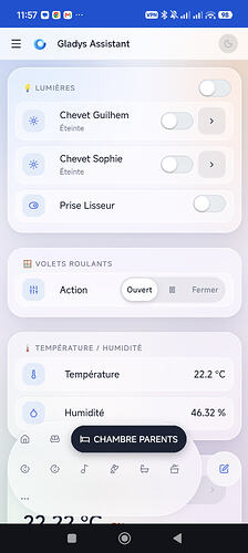

I’m adding a point about the navigation bar: on mobile, when I switch from landscape view to portrait view, the navigation bar is broken until a refresh.
