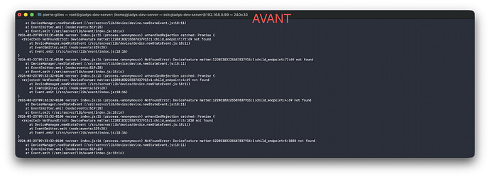

1/ In the logs, warning messages when a device has not yet been added to Gladys are now displayed on a single line, at the « info » log level, because it’s not an error per se but just a warning:

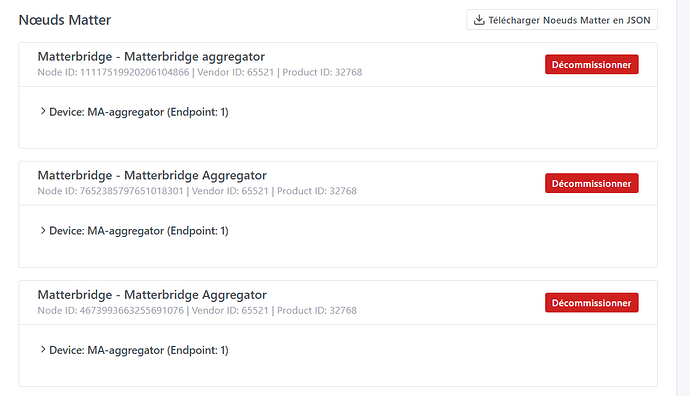

After the migration I see 3 matter nodes:
I’ll send you the logs in a DM
There may be remnants due to my various tests.
Otherwise I would need to completely remove matter and start from scratch by integrating matterbridge as if I were starting from an installation with the latest stable version of Gladys and then use upgrade-matter-latest

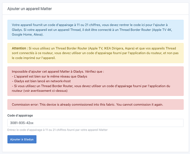

Then I tried to reintegrate my SONOFF switch (which still doesn’t appear in the Matter nodes): sharing the code from HA, adding it in Gladys and problem:
My main issue is that I don’t know how to delete this device which I can’t see anywhere.

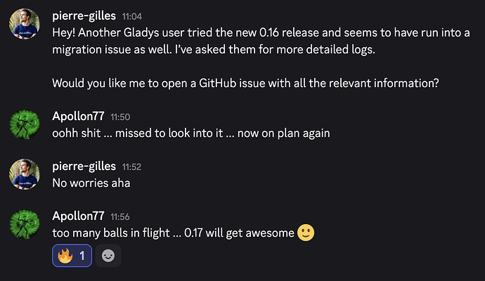

No news! I just pinged him again; it’s been a week.
If needed, we’ll create a GitHub issue on the matter.js side.
I received news this morning, @prohand I’ll keep you updated as soon as I have any updates :slight_smile:

Still no news, I created a ticket on Github so he doesn’t forget :slight_smile:
