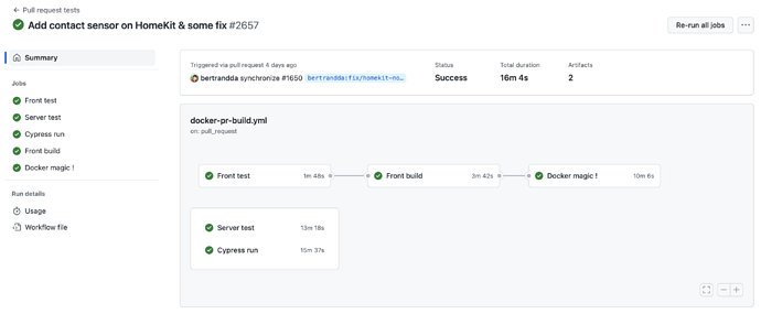

Before/After

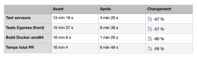

I didn’t think it would be this impressive, but basically here’s the execution speed of PR tests:
Before (example on the last PR)
Now (on my PR):
It just goes to show that keeping software and technologies up to date is important and actually useful :blush:
I have to admit that’s a pretty crazy performance gain!
There are several reasons for this improvement; it’s not just upgrading to Node.js 16/18 that’s the key:
  • Open-Zwave was a library based on C++ bindings that had to be built at each npm install + docker build for every architecture. Removing this lib contributed a lot.
  • Before Node.js 16, the WebCrypto API wasn’t available in Node.js, so I used a polyfill that had to be compiled at each npm install + each docker build for every architecture.

  • We’re moving to a more recent version of sqlite3 which has proper bindings with the Node-API, and which is normally pre-compiled for each architecture; likewise, we save a build per npm install + docker build per architecture.
In short, the ecosystem has evolved a lot and not using the latest version of Node prevented us from adopting many new optimizations.

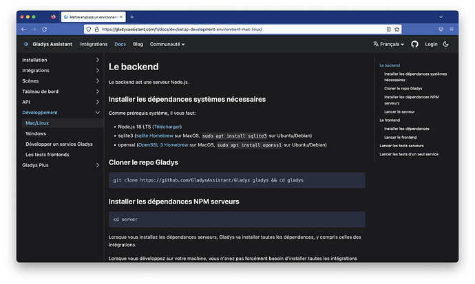

I updated the Linux/MacOS developer documentation, which is now much clearer in my opinion — open-zwave is done :slight_smile:
FYI, in the end I moved to Node.js 18 on the back and the front, so no Node 16.
For the Windows documentation, could someone give it a pass and check that everything works well with Node.js 18 LTS on WSL and update the documentation? Thanks!

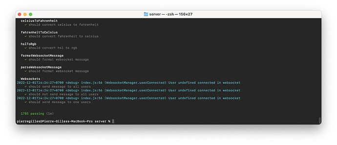

On Apple M1 Pro, it’s really impressive now, the 1785 backend tests run in 1 minute :sweat_smile: I’m saving a ton of development time!
And there’s still room for improvement, there are 4-5 tests on the MQTT and Zigbee2mqtt services that take 10 seconds each, so almost half of the total test time is spent on these integrations.

Efficient :smiley: It’s merged, the new Windows tutorial is live on the site:
