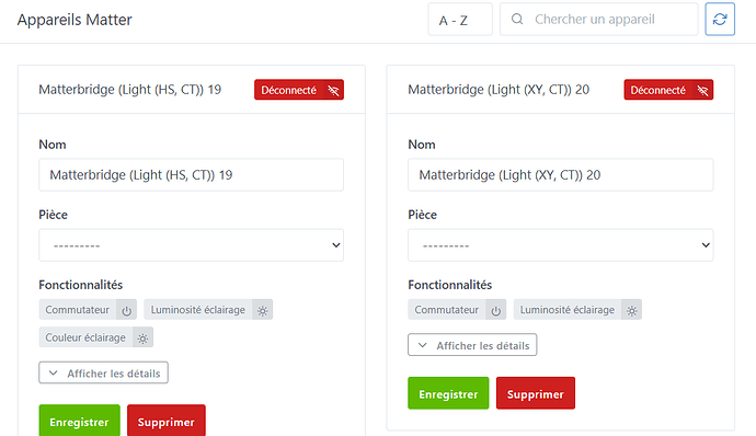

I still have the devices disconnected:

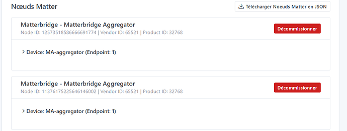

And I see 2 Nodes:
I did see logs regarding a matter migration.
In any case, there’s something more compared to the last time, I suppose thanks to the debug log.

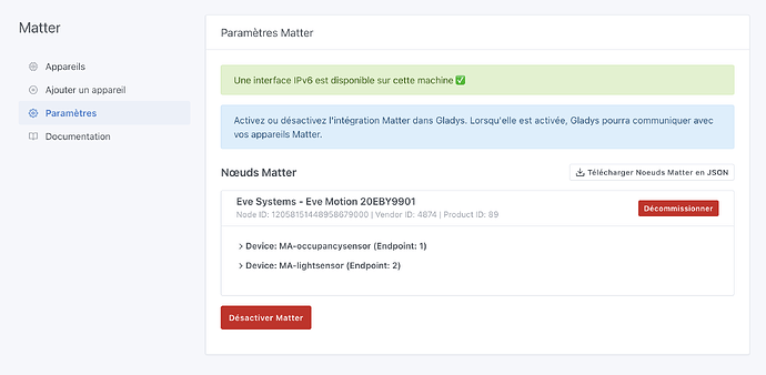

@prohand I just added a button in the interface:
Available on the same Docker image!
