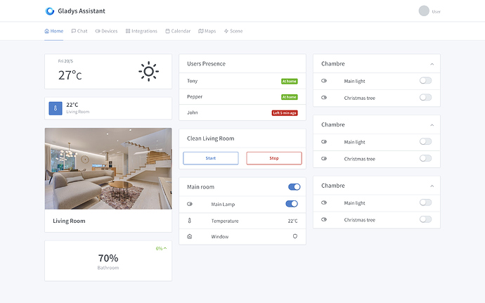

2/ The dashboard design
This afternoon I did (a little) CSS
I spent a bad afternoon, haha :joy:
For now, I’ve started with a 3-column grid like on the Gateway.
I’ve defined a set of boxes, for now it’s just a first draft.
I find that some boxes have too much « white » but I don’t know how to fill that.
Of course all this is available on the demo site =>
In my opinion, you can never have too much white. I think it’s great. Now multi-theming could address this taste issue.
Good job :wink:
Frankly, well done because I find it great! It’s not necessarily too « white », it’s just well and clean.
A small clarification on, for example, the room temperature, it would be interesting to be able to associate a dimmer with it to have the exact room temperature and the setpoint temperature.
What I see is the possibility of clicking on it and having a dimmer (like on the iPhone for brightness, for example).
Otherwise, I like it :slight_smile:
Great idea!
We’ll see how we can fit this in this small box, it could just be a + and - button to increase/decrease the brightness.
You make me think, we don’t have in Gladys for now this notion of current state and desired state.
I don’t know what form it could take, is it just a state change that takes a long time or a property to store somewhere… If someone has feedback on how other platforms do it, I’m interested! :slight_smile:
Thanks! :slight_smile:
Thanks too, it’s nice! :stuck_out_tongue:
Let’s see how we could fit this into this small box, it could just be a + and - button to increase/decrease the brightness.
Be careful not to overdo it though. You can for example have a small icon where you click on it and a modal opens for example.
You remind me, we don’t have in Gladys for the moment this notion of current state and desired state.
Indeed, I saw with my netatmo that for example I can set a setpoint and the device’s goal is to follow this setpoint. Similarly for example for opening/closing shutters, all these things that take a few seconds.
Is it just a state change that takes a long time or a property to store somewhere
It all depends on what you want to do, if the goal is to give the user a metric or just a status like « in progress », « closing in progress »…
Generally, everything is the same, with a few details: the sequences indeed, and also an integrated wake-up light feature, and other On/Off functionalities related to the time. But that would be specific parameterization in the module.
In fact, there are many controls for a bulb, in the case of RGBW you have at least 5: RGB color and brightness, White temperature and brightness, and On/Off. Which therefore makes 5 lines in the IHM which quickly takes up space when you multiply the bulbs.
You can either hide controls or use a module group (template) like for example:
(o)  ------o-------   o
 o   ---o----------  (o)
The vertical switch on the left would allow switching from color to white, the one on the right would be an on/off button. the seekbar at the top for the hue or temperature depending on the first button, and the one below, for the brightness in color and white.
The color to white switch button would only replace the visible controls, from one mode to another without affecting the bulb itself. (thus switching from color control to white would not immediately put the bulb in white until the user has intervened)
The template system could be adapted to other cases of « complex » connected objects. This would thus gain clarity in the IHM.
If you have other ideas for complex objects, I’m interested! (I’ll try to make quick diagrams to give you a more visual preview :slight_smile: )
In the case of a temperature, one can imagine a seekbar with a semi-transparent marker for the current value, a full marker for the desired value. Between the two, the seekbar would have a movement from the first to the second to symbolize that there is an operation to go from one state to another. You could even tint the section of the seekbar red to say that you are heating and conversely blue to cool down :slight_smile:
You can be, it’s great! :+1:
Are you planning to keep the icon of a switch (to the left of the lines) for everything that is on/off, or are you going to put the icon of the type of object controlled (a tree/a garland, a bulb etc.)?
Well, on the other hand, white is bad, I would have Dark Reader activated all the time :stuck_out_tongue: so a night mode (gray and/or black) would be cool! :smiley:
