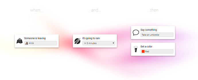

I had some time to kill at work this week, so I did some research about the scene editor’s UI.
So I was heavily inspired by Homey’s « Flows ». For those who don’t know, Homey is a home automation system designed by the company Athom, and it’s horribly expensive (that’s actually why they’re not emerging).
Even if they don’t manage scenes as complex as Gladys 4, their UI approach is very friendly. So I wrote a quite complex scene to push the reflection starting from their horizontal and card-based approach.
To see what I’m talking about, here’s a typical example from them:
So here's the scene I wrote

This is typically the kind of scenario I have at home with Gladys 3 currently :stuck_out_tongue:
I did some drawings on paper but as I’m a poor drawer, I made some drafts to illustrate my ideas as best as possible!
Main scene screen
Editing the « Wake up Tony » scene mentioned earlier
Part 1
Part 2
Part 3
Part 4
As you can see, I took most of Homey but modified the structure to adapt it to scenes much more complex than Gladys 4 will be able to manage. (Maybe it lacks a bit of color) I specify that these are just mockups and that it’s done quickly :sweat_smile:
All suggestions are welcome! :slightly_smiling_face:
