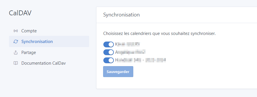

I’m trying to connect my calendars hosted at Informaniak to Gladys
I can see my 3 calendars coming through:

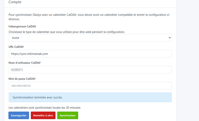

The sync seems ok after the second click on the ‹ synchronize › button:
However, on the first click I see this message

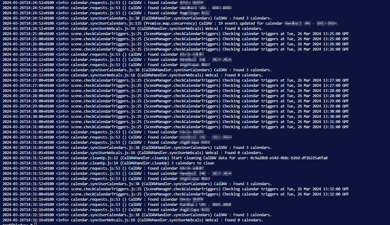

Here’s what I have in the logs:

Hi! Don’t you have any error logs? I don’t see anything unusual in your logs
I’m tagging @bertrandda who is the developer of this integration :slight_smile:
No error logs unless a command lets you display a more verbose mode ; )
Hi, are you connected via Gladys Plus? I don’t have it so I can’t recheck, but it seemed to me at one time that when the first synchronization took too long the Gladys Plus request would time out and it would show the error you have in the CalDAV configuration interface (no error in the docker logs since the synchronization completed correctly in the background). Try clicking on « remettre à zero », then restart the synchronization.
