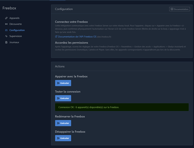

Quick question, did you give access to the Gladys integration to the Freebox functions in the Freebox settings?
By default, the player is not authorized.
In the logs, it doesn’t find any device
[2026-08-01T09:56:07.673Z] [INFO] [freebox-devices] Freebox discovery: 0 device(s) built
[2026-08-01T09:56:07.682Z] [INFO] Freebox: 0 device(s) published (core count: 0)
On my side, I get the same message when I don’t authorize the app in the Freebox and when I give the permissions, here’s what I get:

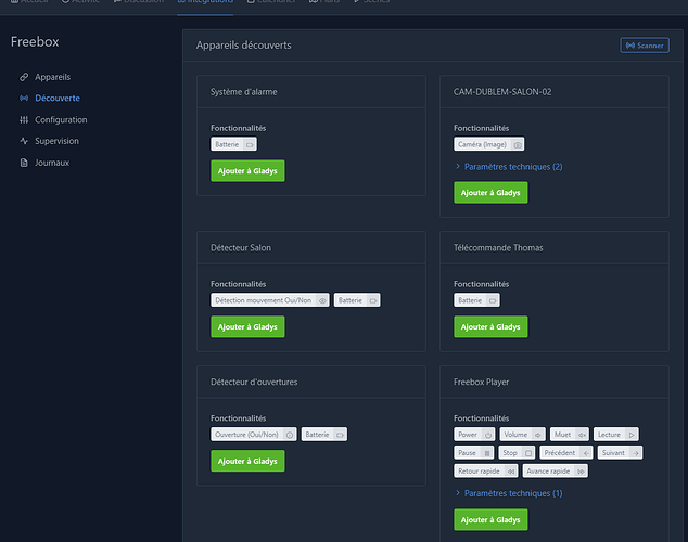

[2026-08-01T11:41:22.286Z] [INFO] [freebox-convert] Freebox camera "CAM-DUBLEM-SALON-02" detected with stream URL: http://freeboxcam:[password]@0.0.0.0/img/stream.m3u8
[2026-08-01T11:41:22.959Z] [INFO] [freebox-convert] Freebox player "Freebox Player" (id=17, api=v15) converted with 10 feature(s): freebox-player-17-binary, freebox-player-17-volume, freebox-player-17-volume-mute, freebox-player-17-play, freebox-player-17-pause, freebox-player-17-stop, freebox-player-17-previous, freebox-player-17-next, freebox-player-17-rewind, freebox-player-17-forward
[2026-08-01T11:41:22.959Z] [INFO] [freebox-devices] Freebox discovery: 6 device(s) built
[2026-08-01T11:42:12.942Z] [INFO] onScanRequest -> publishing discovered Freebox devices
[2026-08-01T11:42:12.962Z] [INFO] [freebox-convert] Freebox camera "CAM-DUBLEM-SALON-02" detected with stream URL: http://freeboxcam:[password]@0.0.0.0/img/stream.m3u8
[2026-08-01T11:42:13.340Z] [INFO] [freebox-convert] Freebox player "Freebox Player" (id=17, api=v15) converted with 10 feature(s): freebox-player-17-binary, freebox-player-17-volume, freebox-player-17-volume-mute, freebox-player-17-play, freebox-player-17-pause, freebox-player-17-stop, freebox-player-17-previous, freebox-player-17-next, freebox-player-17-rewind, freebox-player-17-forward
[2026-08-01T11:42:13.340Z] [INFO] [freebox-devices] Freebox discovery: 6 device(s) built
[2026-08-01T11:42:13.347Z] [INFO] Freebox: 6 device(s) published (core count: 6)
[2026-08-01T11:43:28.749Z] [INFO] Device created in Gladys: "Système d'alarme" (ext:ext-william-de71-gladys-freebox:freebox:6, selector=freebox-6, 1 feature(s))
[2026-08-01T11:43:28.753Z] [INFO] onPoll <- ext:ext-william-de71-gladys-freebox:freebox:6
[2026-08-01T11:43:30.176Z] [INFO] Device created in Gladys: "CAM-DUBLEM-SALON-02" (ext:ext-william-de71-gladys-freebox:freebox:7, selector=freebox-7, 1 feature(s))
[2026-08-01T11:43:30.178Z] [INFO] onPoll <- ext:ext-william-de71-gladys-freebox:freebox:7
[2026-08-01T11:43:31.430Z] [INFO] Device created in Gladys: "Détecteur Salon" (ext:ext-william-de71-gladys-freebox:freebox:8, selector=freebox-8, 2 feature(s))
[2026-08-01T11:43:31.432Z] [INFO] onPoll <- ext:ext-william-de71-gladys-freebox:freebox:8
[2026-08-01T11:43:32.744Z] [INFO] Device created in Gladys: "Télécommande Thomas" (ext:ext-william-de71-gladys-freebox:freebox:10, selector=freebox-10, 1 feature(s))
[2026-08-01T11:43:32.746Z] [INFO] onPoll <- ext:ext-william-de71-gladys-freebox:freebox:10
[2026-08-01T11:43:33.777Z] [INFO] onPoll <- ext:ext-william-de71-gladys-freebox:freebox:6
[2026-08-01T11:43:33.788Z] [INFO] onPoll <- ext:ext-william-de71-gladys-freebox:freebox:10
[2026-08-01T11:43:33.841Z] [INFO] onPoll <- ext:ext-william-de71-gladys-freebox:freebox:8
[2026-08-01T11:43:34.039Z] [INFO] Device created in Gladys: "Détecteur d'ouvertures" (ext:ext-william-de71-gladys-freebox:freebox:12, selector=freebox-12, 2 feature(s))
[2026-08-01T11:43:34.042Z] [INFO] onPoll <- ext:ext-william-de71-gladys-freebox:freebox:12
[2026-08-01T11:43:35.300Z] [INFO] Device created in Gladys: "Freebox Player" (ext:ext-william-de71-gladys-freebox:freebox:player:17, selector=freebox-player-17, 10 feature(s))
[2026-08-01T11:43:35.301Z] [INFO] onPoll <- ext:ext-william-de71-gladys-freebox:freebox:player:17

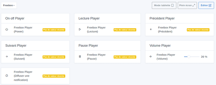

Great, everything is integrated, I just need to test the features. I created a dashboard using « Devices » but the buttons have no action.
Jluc
August 1, 2026, 2:15pm
26
The volume control works well but it’s a bit small on a phone. The finger on the slider generates too large deviations.
The shutter opening command just sends a pulse and the closing command has no effect.
@Jluc we’re making progress…so what was the issue with permissions then?

For permissions, I checked almost all the boxes.
For the cameras, I didn’t get any requests for codes, but I have no feedback, no images, no video.
For the dashboard, I may not have done what was needed, as no buttons work except the volume. I will make a request for it to be more practical.
The motion detector provides no information. Will it be possible to use it as a trigger in scenes?

I can’t test the player, but I found that the issue isn’t necessarily the integration. There’s a problem with the TV devices on the dashboard.
For this, I added an MQTT device to test and I got the same result. I added a Play button with the Television.Play functionality
However, on the dashboard, I have the same display as you
So it’s a bug on Gladys’ side. @pierre-gilles do you want me to prepare a PR for this?
