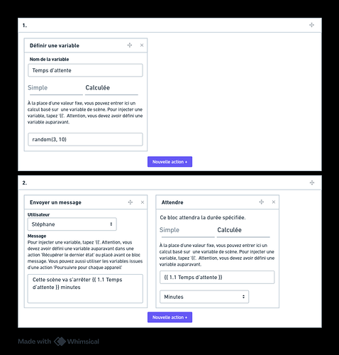

Today, in a scene I wanted to configure a waiting time depending on the level of my tank and send myself a message informing me of that waiting time. The way the « Wait » action has evolved lets me do the calculation there, but I can’t do the same in « Send a message ». And even if it were possible, I’d be annoyed to have to write the same formula twice.
The solution, of course, is to define an MQTT device, then in the scene put my formula in a « Control a device » action, then use a « Retrieve the last state » action to use it in « Wait » and in « Send a message ».
But in reality, it’s tedious
I would find it very convenient to have an action, perhaps named « Set a variable », to define a simple or calculated value, then retrieve it later in all actions that accept a variable.
It would look like this :

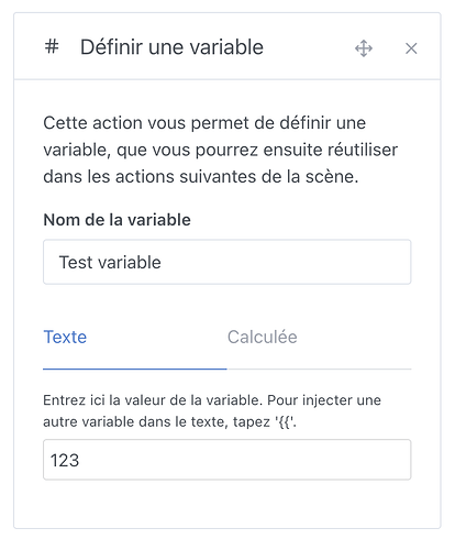

It’s developed:
master ← claude/dazzling-archimedes-sqfxn8
ouvert 02:20AM - 14 Aug 26 UTC
### Description
Adds a new scene action **"Set a variable"** (`variable.set`) w… hich lets a scene define a value once — either a simple text or a computed formula — and re-use it in every following action.
Until now, the only way to compute a value once and use it in several actions was to create a permanent MQTT variable device, write to it with "Control a device", then read it back with "Get device value". As described on the forum, that workaround is tedious and leaks state between scenes.
**How it works**
The action stores its result in the scene scope under its own action path, exactly like the actions that already expose variables. It is therefore available in the next actions as `{{1.0.value}}` — the coordinates of the action, followed by `.value` — and shows up automatically in the `{{` variable picker of every action that accepts variables.
Two value types are supported, following the same *Simple / Computed* tab pattern as the "Wait" action:
- **Text** — a Handlebars template rendered against the scene scope, so it can itself contain other variables.
- **Computed** — a formula rendered against the scene scope, then evaluated by the restricted mathjs instance used by the other scene formulas.
Both modes fail closed: the scene aborts with `VARIABLE_VALUE_NOT_A_NUMBER` if the formula cannot be evaluated or does not return a finite number, with `VARIABLE_TEXT_NOT_VALID` if the text template cannot be compiled, and with `VARIABLE_VALUE_AMBIGUOUS` if an action carries both a `text` and an `evaluate_value`.
An optional **variable name** can be given; it is only a display label, shown in the variable picker of the following actions (`3.1. Waiting time` instead of a bare path).
**Verified in the UI**
Checked locally in demo mode: the new card shows the description, the "Variable name" field, the Text/Computed tabs and the value input; after setting a variable named "Waiting time" in group 3, typing `{{` in a following "Send Message" action offers `3.1. Waiting time` in the picker. Switching between the Text and Computed tabs clears the value of the other tab, in the stored action and in the displayed field.
