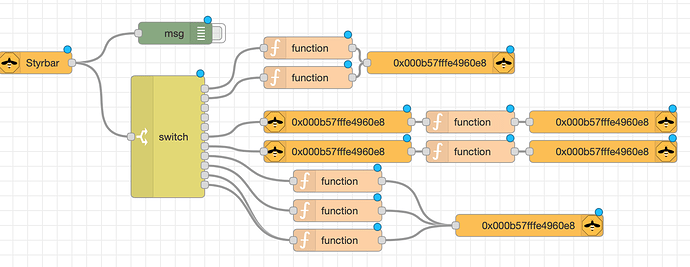

Here’s what I did in the meantime:
In short, via a Z2M node, I retrieve the click action, then via a big switch, I send the info to the desired lamp, still via other Z2M nodes

I didn’t overthink it, I admit :slight_smile:
