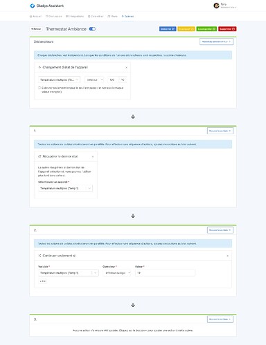

Otherwise, what’s stopping you from doing this:
You put an arbitrary condition in the trigger.
Here I put WHEN « temperature » is less than 120°C, which will always be true (unless you live in an oven)
And then you put your logic, and it will always be executed

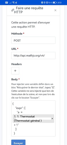

So I make a scene in which I retrieve the thermostat value, send the operation via mathjs and then…
Mathjs doesn’t accept my ‹ Thermostat › variable even though it works with numbers and then…
I don’t know how to choose the result in « control a device » towards a dummy MQTT device.
Does what I’m trying to do match the problem mentioned above? Is it not supported? How off-base am I?

Are you testing by executing the global scene, and not by clicking the « Try » button on the HTTP request? The Try button does not send variables because it only executes that part of the scene

Yes, and the error message is: ‹ Error: Syntax error in part \u0026quot; + 1\u0026quot; (char 10) ›.
My scene block looks like this :
If I put ‹ 20 › instead of the variable, it works…
As such, it’s not a big deal since the math functions will be integrated, but I’d like to know what I’m doing wrong…

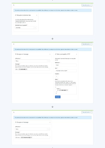

@GBoulvin I tested it at home by creating this scene:
I start the scene and in my messages:
