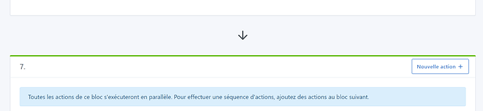

Being able to add an action block (numbered boxes) between two blocks
  • a small + button next to the transition arrow?
    And while we’re at it, like in the Dashboard editor, little arrows to move blocks up/down? (see below)
It also seems to me that the « new action » button would be more useful at the bottom of the block to avoid endless scrolling.

I added a few images to try to be clear
