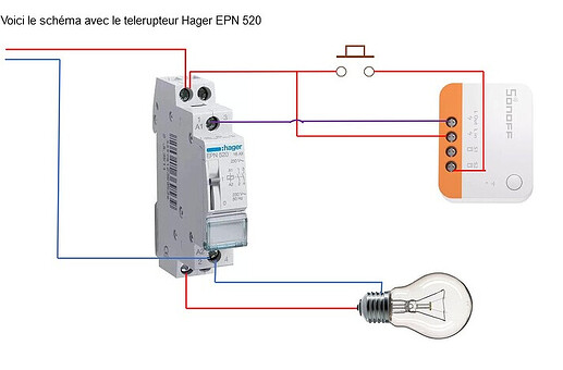

ZBMiniL2 wiring diagram with impulse relay
But on reflection, you’re probably right — it acts as an impulse relay. That would explain why every other time nothing happens with the real impulse relay.
Well, since you don’t send a pulse to the impulse relay with the Sonoff it’s normal that you’re forced to do on off and then off on.
The impulse relay changes state on a rising edge, so when you go from off to on.
Since you put the Sonoff and then the impulse relay you can’t have state feedback.
The only way is to replace the impulse relay with the Sonoff.

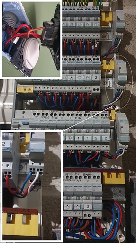

I just found this thread and it apparently talks about impulse relays… so when I opened my panel (attached) I discovered that on 3 lines at the end there is one, so that corresponds well to the 3 zones where I have push-buttons.
According to what is written above, it is in place of this impulse relay that I must put the module, which already makes me less keen to intervene at that spot but why not since I understand the issue and the principle.
My questions:
Is that really what I should do? Disconnect the impulse relay and put a Sonoff module in its place and not place it in a box behind a push-button as originally planned?
Second question: rather than playing the mad scientist, with the attached photos can you tell me where to connect the 4 wires of the impulse relay to the Sonoff even though I have a rough idea for 2 or 3 of the 4 — I’d rather be sure than try at random.
Will my push-buttons in the house still work?
Thanks to everyone in advance.
Hello @Thomas02,
You can indeed place your Sonoff in the position of the impulse relay (télérupteur) in your electrical panel.
However, make sure you correctly identify the impulse relay concerned :wink: (for example, the relay you circled is not the one you enlarged :blush:).
As for the wiring, normally, from what I’ve seen online regarding the Hager esp 510b, the red wire would go to Lin of the Sonoff, the purple wire to Lout, the white wire to S2. I say normally because I’m not an electrician, and the wiring of your impulse relay doesn’t seem to be done to standard (the blue wire is supposed to be on A2, and the white wire on A1). You need to check that the red wire is indeed coming from the circuit breaker, and if you can confirm that the purple wire goes to the lamp and the white wire to the switches you would be certain.
Otherwise, if someone else could confirm they think the same as me, that would be helpful.
For the blue wire, put a domino or Wago on the end for protection (you can also remove it but if you want to put your impulse relay back for some reason, this will save you from having to reinstall it).
Then you will need to configure your Sonoff so it is in push-button mode (by default it is in toggle switch mode).
All that’s left is to adapt it to your impulse relay

Indeed, I have correctly identified the latching relay concerned; the photo was just an example. However, it’s difficult to confirm that the purple wire goes to the lamp — you’d have to remove the spotlights, and even then. As for the white wire toward the switches, as you can see in my photo, it is not present behind the switches.
We agree that I shouldn’t leave any wires on the latching relay? I remove them to put them on the Sonoff? No jumper wires between them? I’m worried about the operation of the push buttons — will they still work or not.
