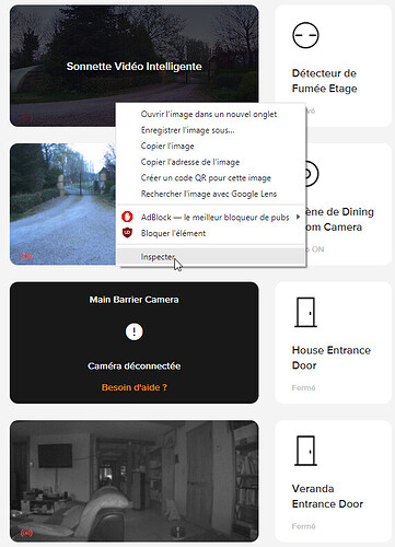

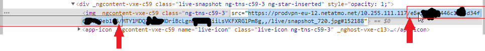

2nd point: For those who have Netatmo Presence (Outdoor) or Welcome (Indoor) cameras and would like to access them from Gladys without the ongoing integration (which unfortunately is taking a long time to appear due to the numerous complex changes requested), I have just found a way to access the live stream via the IP address (which bothers me a bit actually as there is no login/password to enter!!) and which allows you to always have the stream even in case of an internet outage (I’m thinking of you @Tlse-vins but maybe you already found a way to do it ^^) :
