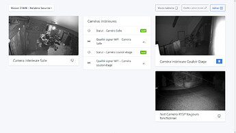

Image de test disponible : docker pull terdious/gladys:netatmo-security-nacamera

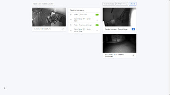

When will we get 1920x1080 ?? :crazy_face: Or the option to choose the number of columns ?? Amount of empty space ^^ :sweat_smile:

PS: @pierre-gilles speaking of the columns, I noticed that the columns are not equal in size… the middle column is slightly shorter in the middle than the left and right ones. After Netatmo I’ll look to see if I can fix it.
