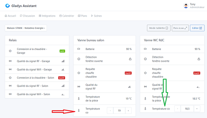

PS (continued):
So I’m not talking about the height but the width. For example, with the same name at the limit of double lines we have this:
It’s silly but it comes down to 1 character (368px for the center versus 378px for the left and right columns), if I add the ‹ n › of « consigne » on the right it indeed jumps the line:
I thought it was related to the free spaces between the columns, but no we have 27 or 28px on each side.
