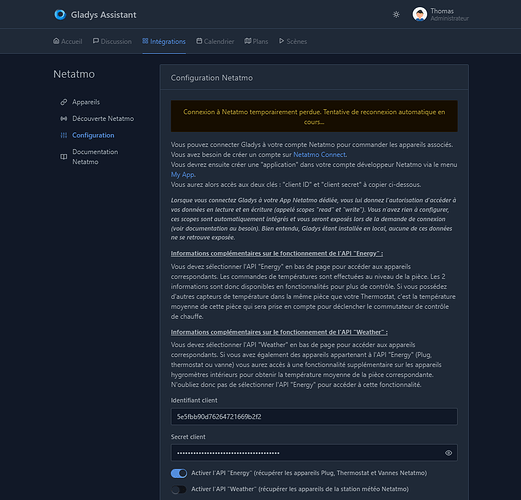

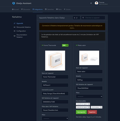

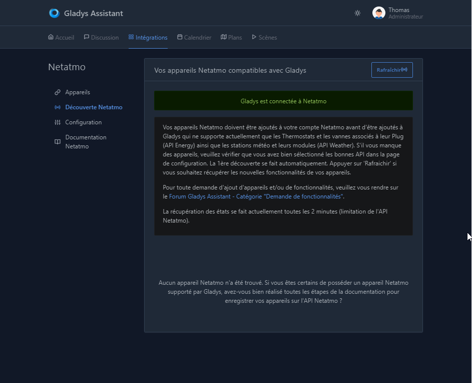

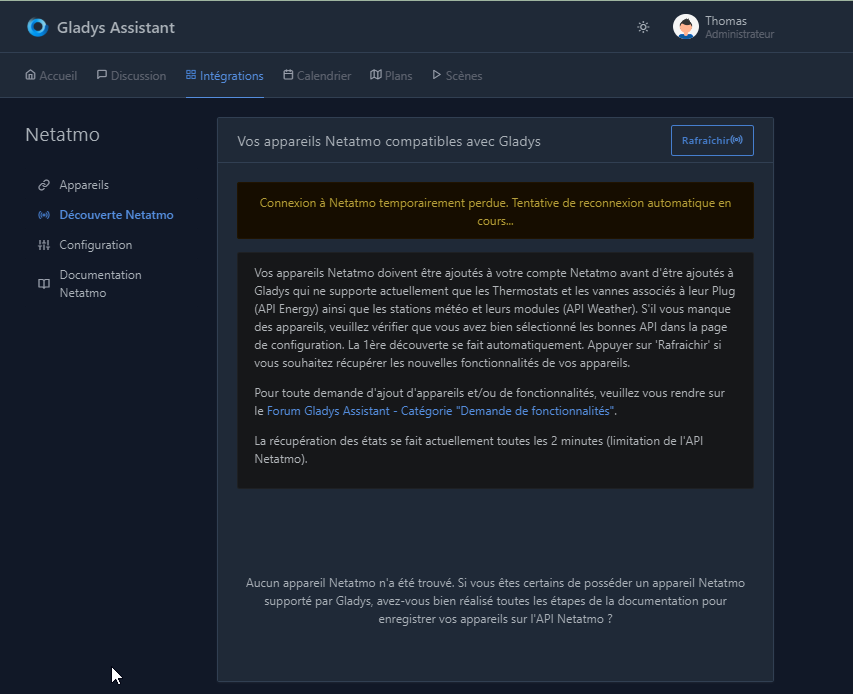

I noticed, especially on HA, that there should be no Authorization header on /oauth2/token. I’m also taking this opportunity to improve the user info feedback on the front end during a reconnection on the setup page.
PR created here:
I took the opportunity to create a second PR to improve the existing feedback as well. In some error cases, the integration wasn’t detected as disconnected and remained visually as « Connected » even if it wasn’t the case (e.g., failed discover). So I’m taking the opportunity to reuse the automatic reconnection function. PR2:

For info, the evolution also triggers the automatic reconnection cycle when Netatmo rejects the access token. Without this, clicking on « Refresh » on the Discovery page or retrieving values when the Netatmo application is disabled did not trigger any error message.
We now have clear information about the reconnection status on all integration pages. The retry cycles are: 30s → 60s → 120s → 300s, then 300s recurring indefinitely.
