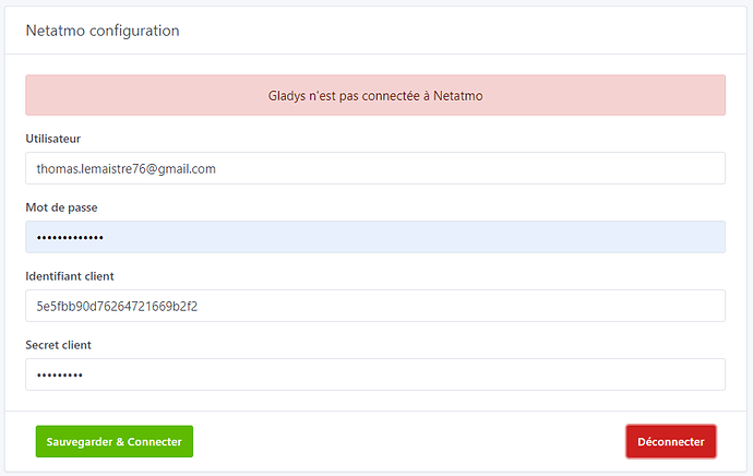

  • Settings View, Creation of a logout function as well as the associated command in the front-end
  • Settings View, Loading message during connection
  • Settings View, Clearly display whether Gladys is connected or not to the API: Message displayed permanently for one and the other case
    In Images for the 3 previous points
  • Settings View, take back the « placeholder » Object Object of the fields to fill in the settings view
    In Image

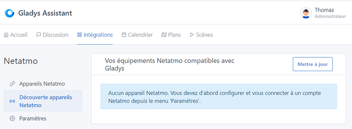

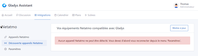

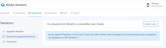

  • Discovery View, add a message if nothing to display because not connected or if no information received or if not configured
  • Discovery View,
    In Images for the 2 previous points
    If no information entered in the settings:
    If information entered but disconnected from the API:
    If connected to the Netatmo API but no devices retrieved:

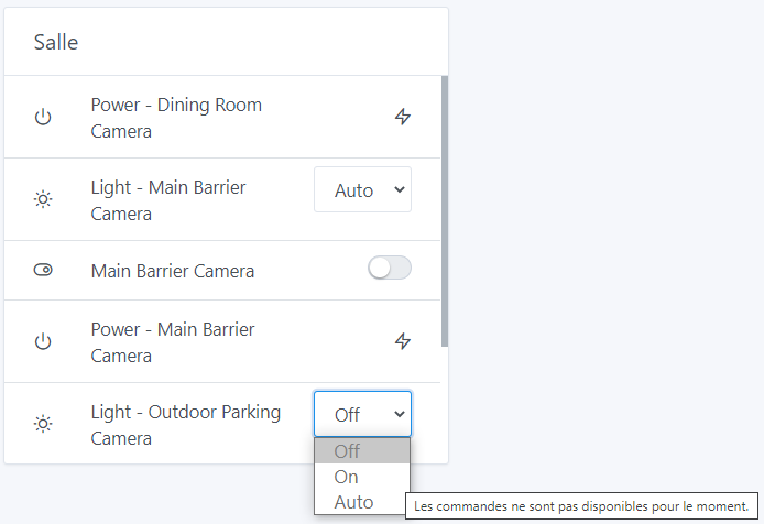

  • Dashboard View: in progress, detach the lines specific to Netatmo from the common boxes (Done). Signal and gray out the information returns that will later also be commands (comments in « title » added)
  • Dashboard View: Gray out and signal the lines when Netatmo is disconnected.
    In Image
  • Dashboard View: take back the category/type that was undefined and modify the icons that were not clear enough.
    In Image

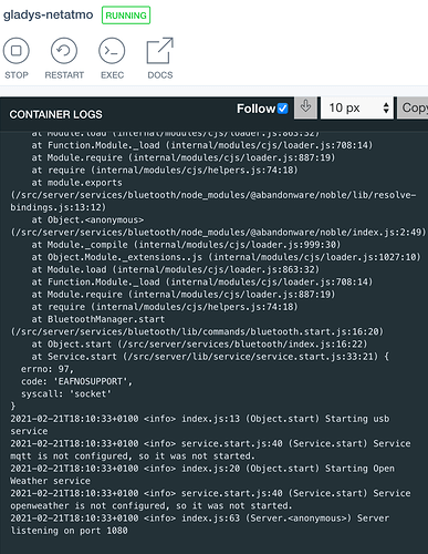

Hello, I’m taking a few minutes to test:
I ran the following command on my machine:
docker run -d \
--log-opt max-size=10m \
--restart=always \
--privileged \
--network=host  \
--name gladys-netatmo \
-e NODE_ENV=production \
-e SERVER_PORT=1080 \
-e TZ=Europe/Paris \
-e SQLITE_FILE_PATH=/var/lib/gladysassistant/gladys-netatmo.db \
-v /var/lib/gladysassistant:/var/lib/gladysassistant \
-v /dev:/dev \
-v /run/udev:/run/udev:ro damalgos/gladys-netatmo:latest
I see the listening port on 1080 but I don’t think I’m accessing gladys when I type: localhost:1080
Any ideas?
Hello, run a docker ps to list the containers
I specify that my container is indeed started I see it UP via kitematic
Thanks anyway @Jean34 :slight_smile:
Doesn’t Kitematic give you the access URL?
