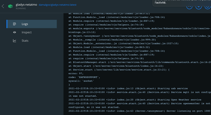

On the Docker desktop client side:
On the command line side, I have:

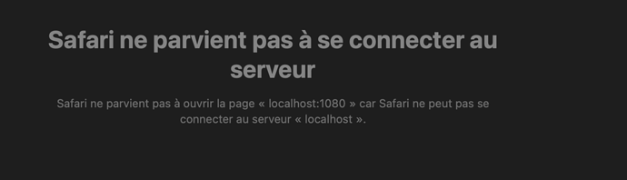

I just wanted to know how to access Gladys because:
http://localhost:1080
returns:
Try 127.0.0.1:1080 to see

Yes I first tried to contact the IP of my Mac or 127.0.0.1 :confused:
Too bad, I’ll try another time or not :smiley:.

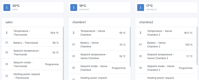

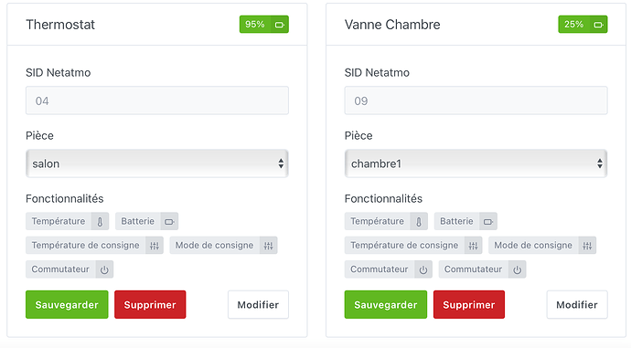

Here is my feedback, I can retrieve my thermostat and the linked valves as you can see:
All of this is great.

  • After entering my information in the settings, I didn’t know if I should click on « Save » first or on « Connection ».

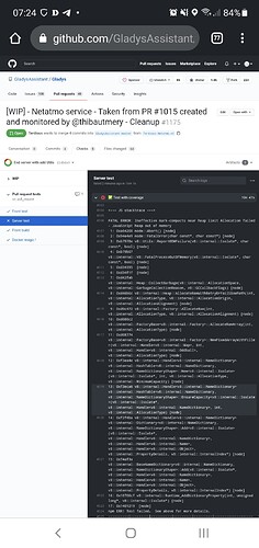

I’ve been working on the Netatmo service development since the day before yesterday, as discussed, starting from scratch with version 4.3.0 and on a new PR for clarity. I think I’ve finished the server part. All my tests work well locally, but the test crashes on GitHub, apparently due to « JavaScript heap out of memory »:
I thought I had increased this limit in the previous PR of @damalgos, and it worked fine. But since the goal is to start from scratch, I’m asking for your wise advice. Testing different types of cameras (working with ffmpeg) is quite long (more than 300ms), and I don’t see how to reduce this time.
If you could take a look, the test is here and the PR#1175 is here
