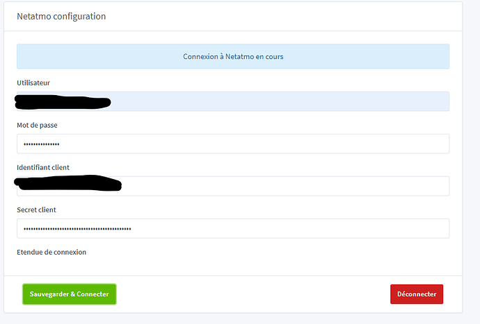

Hi @Terdious,
I just tested your latest image.

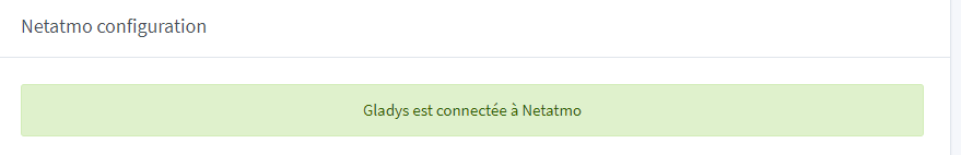

I had already seen this in my first test but it might be useful for the user to see a spinning icon, or a confirmation saying that the service successfully connected without needing to refresh the page
Because currently I’m forced to change tabs and come back to the settings tab to get the confirmation, or to refresh the page.
If I don’t do that nothing happens and it’s a bit confusing because you end up waiting.

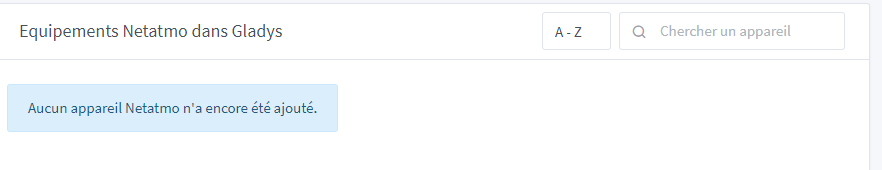

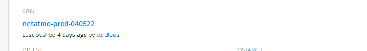

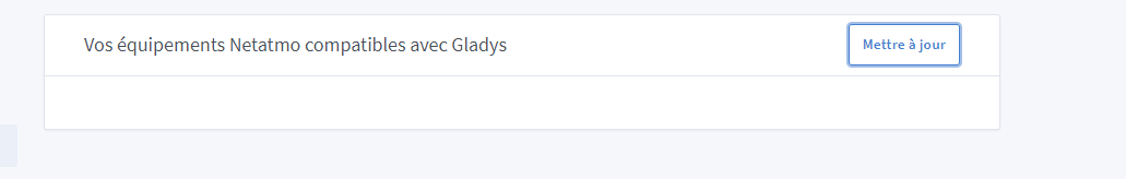

I’m on your 04/05/2022 image but I don’t have what you just pushed for the API selection
And my thermostat isn’t showing
Do you have any idea why?
Hi @_Will_71,
Yes indeed, that was the case before, but since I added the new settings page I have this problem and I still can’t find out why… websockets remain a mystery to me; when it works it’s great but then why does it stop working?? ^^
Mmmmh my bad, I had only tested with my built DB and not with a new DB. Indeed I have the same issue, I’ll change it… actually better yet, since I’m preparing the PR, I’ll let you know as soon as it’s ready!!
Ok, that works :+1:
