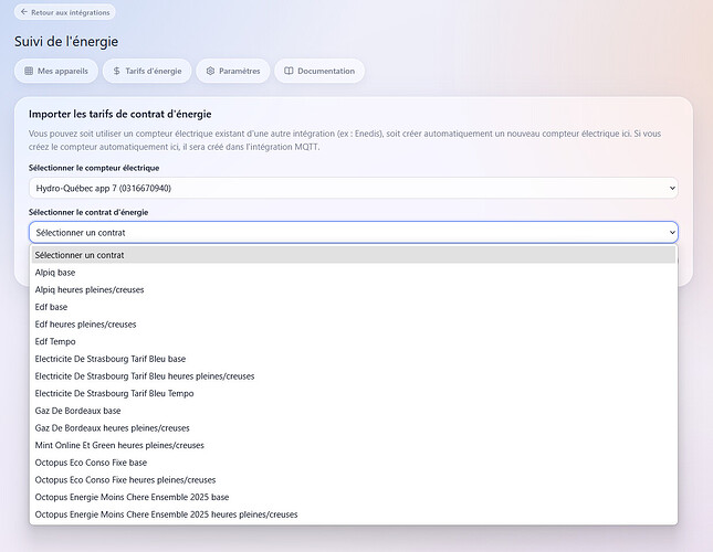

And I realize that everything is designed for French users, without a generic status. I suggest adding at least a « base » or « standard » energy contract.

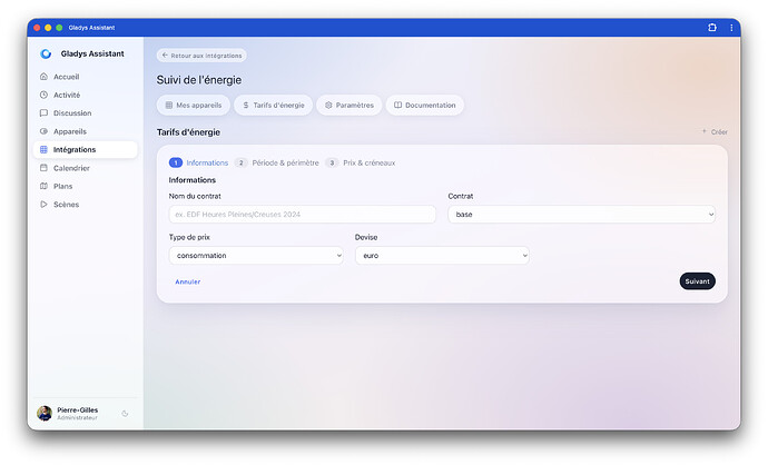

There is indeed a generic mode.
You need to go to the “Create” tab and not “Import” :
The “Import” tab only offers contracts that Gladys knows in its common contract database.
For now, they are indeed all French (I would like that to change!), contributions are welcome on this repository:
Gladys Assistant Energy Contracts as JSON
That said, your comment is relevant: if you haven’t found this option, it’s probably because the interface doesn’t highlight it enough. I’ll improve that
