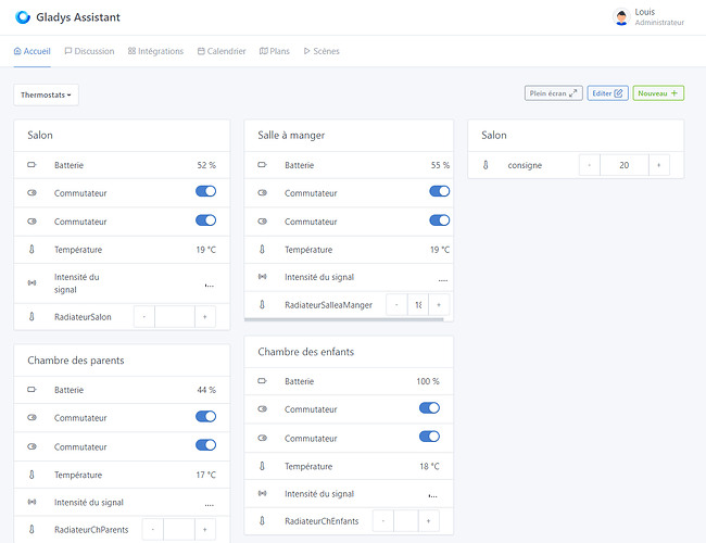

Conteneur lancé, device radiateur mis à jour dans l’intégration Z2M :
I see that the HomeKit service is present, I conclude that this image is based on the latest version with @pierre-gilles’s fixes. But as you can see on the screenshot, the thermostats are cut off on the dashboard (FullHD screen and Chrome 107).
Other feedback :
  • The « Temperature » feature is added by your changes, great! =\u003e It is the temperature sensor embedded in the connected head
  • There’s still « switch » without knowing what it is in the interface =\u003e It’s the [EDIT] « ECO MODE » « lock » child lock and window opening detection
I should add that the temperature control in the interface works well and this is reflected in the Z2M interface.

[quote=« lmilcent, post:2, topic:7634 »]
There is still
Indeed, it’s more related to the connected head model than to the thermostat, but it affects its control, because the « eco » mode causes the setpoint temperature to no longer be used, but the « eco » temperature.
Example: 16°C as eco temperature and 21°C as setpoint temperature => the radiator will heat to 16°C/
As for the thermostat, it’s all good for me apart from the raised point:
  • :white_check_mark: Reporting of the local temperature
  • :white_check_mark: Sending a heating value

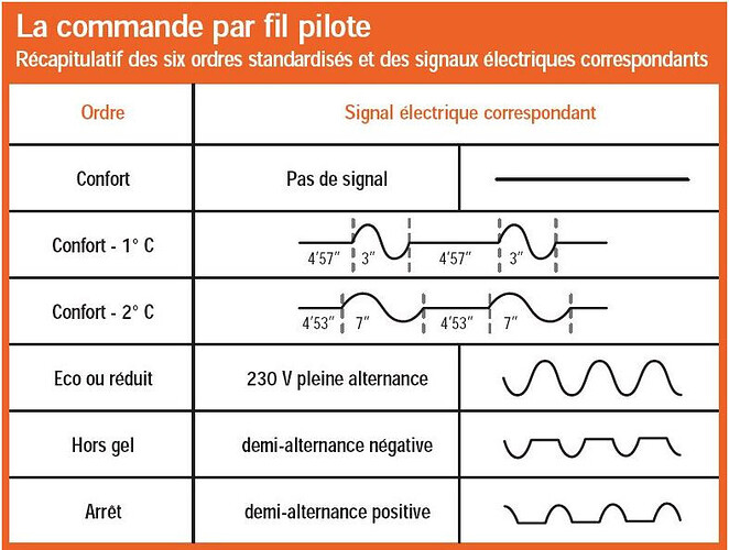

Regarding the operating modes of the heaters, it should be based on the pilot wire (fil pilote):
  • 4-order pilot wire (fil pilote): Comfort, Eco, Frost protection, Off
  • 6-order pilot wire (fil pilote): Comfort, Comfort -1°C, Comfort -2°C, Eco, Frost protection, Off
In Z-Wave, there are devices of the 4-order pilot wire (fil pilote) type.
