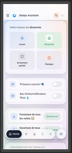

I started working on a native mobile application for Gladys, and I would like to share the approach before going further — especially the choice of architecture, which seems to me the most debatable point and therefore the one on which your feedback will be most useful.
The foundation is functional: the app runs on my phone, connected to my instance, with all my dashboards and cameras.

Tested on a Xiaomi running Android 16 (Chromium WebView 151), against a real instance:
Point Result
Web Crypto (RSA-OAEP 2048, ECDSA P-256, AES-GCM, PBKDF2) 9/9 in https context
WebSocket to an HTTP instance Handshake in 44 ms
MSE / hls.js (cameras) Available
Full path: configuration, login, dashboards, cameras Functional

Lot 1 — Foundation and Authentication :white_check_mark: DELIVERED
Goal: prove that the approach works, and address the tough points 1, 2, and 6.
Commit feat(mobile): resolve the instance to connect to at runtime —
22 files, 1254 insertions, 14 deletions.
  • :white_check_mark: Configuration resolved at runtime (setRuntimeConfig, whitelist of keys)
  • :white_check_mark: utils/native/ layer — eliminated from the web bundle by tree-shaking
  • :white_check_mark: Secure storage (Keychain / Keystore, fallback localStorage on the web)
  • :white_check_mark: Multi-instance profiles: list, add, edit, delete, toggle
  • :white_check_mark: First connection screen, with address test before registration
  • :white_check_mark: « Instances » settings page, hidden on the web (nativeOnly)
  • :white_check_mark: Lost connection indicator in the header
  • :white_check_mark: Safe areas: viewport-fit=cover + top bar and navigation drawer
  • :white_check_mark: Web non-regression manually verified
  • :warning: Gladys Plus connection not functional — see the scheme arbitration, section 8
  • :cross_mark: iOS project not generated: no macOS machine available
Validated on device (Xiaomi, Android 16, Chromium 151 WebView): complete configuration path, connection to the local instance, login, dashboards, cameras.
Checks: the three CI checks pass (Prettier, ESLint 0 errors, fr/en/de translation parity), plus 43 logic tests executed on the real code in the repository.
