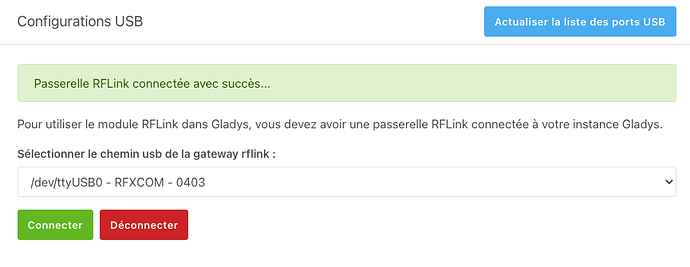

I just restarted a Docker instance to be sure it doesn’t work.
So the USB is detected:

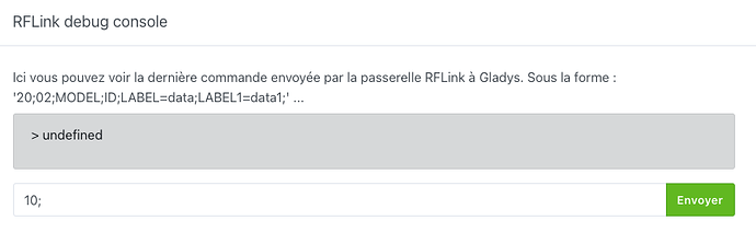

But no info in the debug:

I don’t really know if it’s actually very different, I have no way to test and to know what types of messages RFXCom sends back.
In the debug section, you can try sending messages to your devices and see the response:
For RFLink here are the types of messages that are handled.
Otherwise you can try with RFLink’s debug tool (or see if you have an equivalent) but I doubt it will work.
