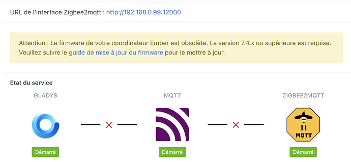

Thanks @cicoub13, that’s really cool!
Tested just now and it works perfectly:
I think this will really help newcomers to Gladys, beyond the Ember aspect :slight_smile: Well done :clap:
Just one remark — couldn’t the error message be improved to indicate the different options: update the dongle’s firmware, or select the legacy ezsp driver?

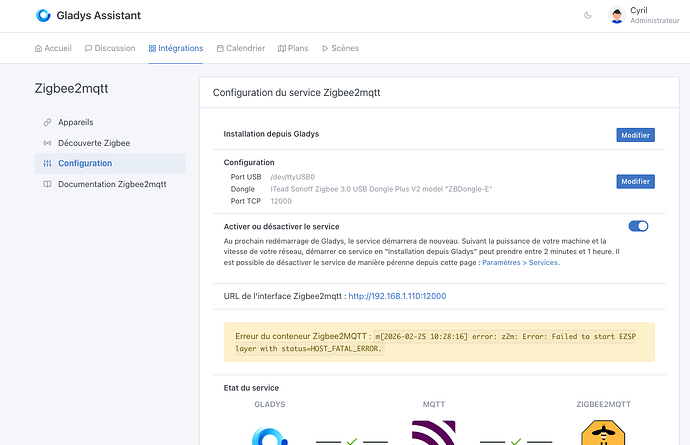

Also, I tested something and I don’t understand why this happens: if I roll back to « ezsp » (I select the old driver + click save), I get this:
It’s only when I click the toggle « disable » + « enable » that I see the services turn green again.
Any idea?
When changing the Dongle, the Z2M container is restarted (with the new configuration file) and not recreated.

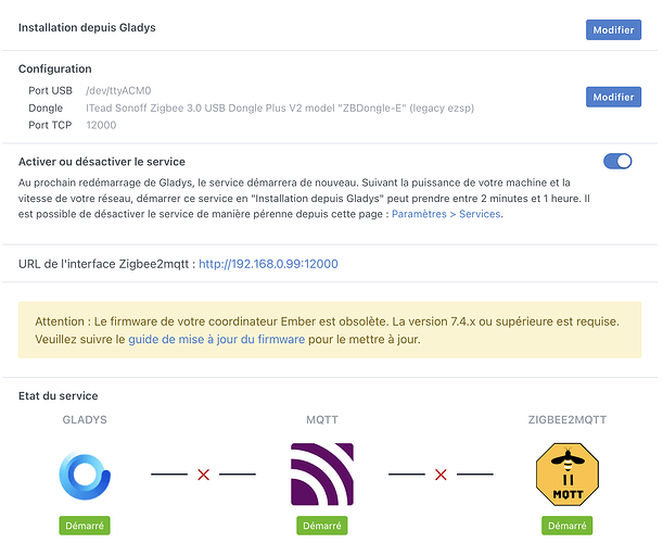

I pushed a commit and a Docker image to recreate the container in case of a Dongle change. I think that’s cleaner. I couldn’t test it in real life and I won’t be able to look at it tomorrow (Thursday).
Yes, I changed it to this “Warning: The firmware of your Ember coordinator is outdated. Version 7.4.x or higher is required. You can follow this guide to update it. Otherwise, select the dongle (legacy ezsp) in the configuration.”

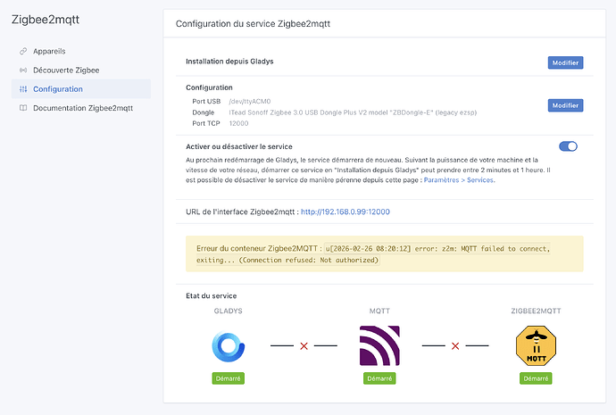

I just tested, I have a different error now :smiley:
The only way to switch from one dongle to another is to do a deactivation + re-activation between each dongle change.
I think that’s already the behavior today. I’ll run tests on Friday to improve it.
