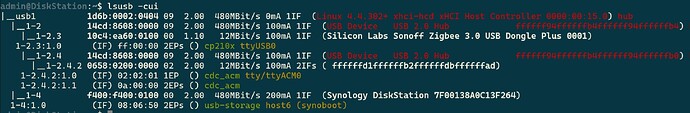

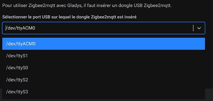

I have the impression that no matter whether I plug in or remove the dongle on the USB port, Gladys only returns this to me:
I still have this list =>
Whereas I can clearly find the dongle with an lsusb =>
What do the dev* correspond to compared to my lsusb?
Could this be related to that?

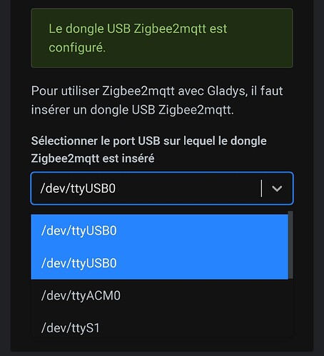

I restarted the Gladys container and now I can see the correct port :
Which matches my dongle :

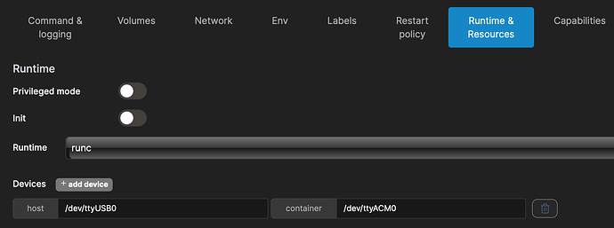

Okay I was able to fix the issue but by fiddling with the image via portainer
I changed the host to /dev/ttyUSB0 which is bind to /dev/ttyACM0.
I don’t know why it doesn’t change when selecting via gladys but it seems ok now.

In the container gladys-z2m-zigbee2mqtt, the dongle’s port is always /dev/ttyACM0 (that was to make configuration easier).
You will still find in /var/lib/gladysassistant/zigbee2mqtt/z2m/configuration.yaml
serial:
  port: /dev/ttyACM0
The mapping between the host port (the real one) and the container’s is indeed done when the container is created (or on reactivation if there’s a change).
"Devices": [
        "PathOnHost": "/dev/ttyUSB0",
        "PathInContainer": "/dev/ttyACM0",
        "CgroupPermissions": "rwm"
