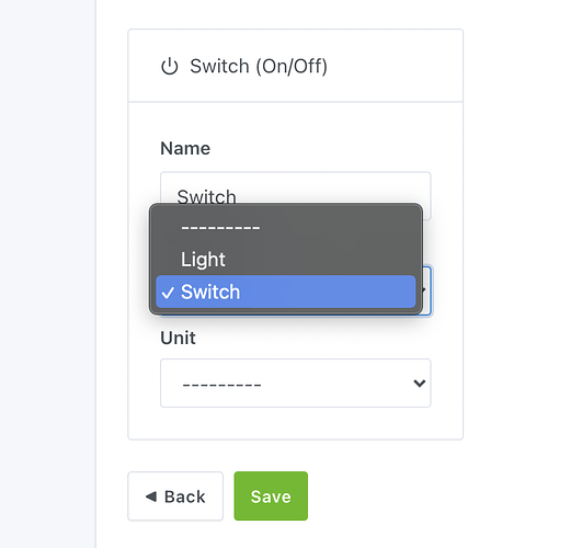

I’ve set up a Sonoff with Tasmota:
When I say « turn on the light » in the discussion, nothing happens:
When I say « turn on the Living Room, » the Living Room switch turns blue but not the light:
However, when I click to switch the living room, the « light » also switches as expected.
Am I making a mistake in the syntax?

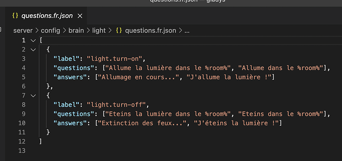

The model’s question file looks like this:
Then, when you say « turn on the living room light », what Gladys does is look for all the devices in the named room, of category « light » and with a « binary On/Off » functionality.

I have correctly configured the Sonoff as « light », by the way when I manually switch the room button at the click the behavior is good.

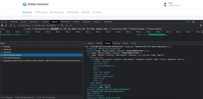

For this, in your browser, on the dashboard, you do « right-click → inspect element »
And you open the GET request /api/v1/room/garage?expand=devices
Then you go to the « preview » tab to see the response and you open the device « lum » and its features.

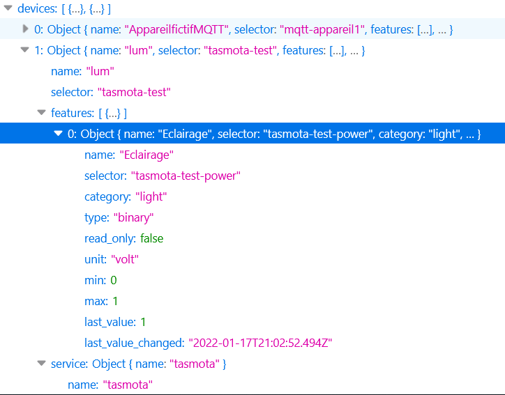

Here is the feedback from the request (‹ lum › is indeed in category: light):

ok, that seems good.

  • Your device seems fine (it is indeed a « light » category, and type « binary »)
