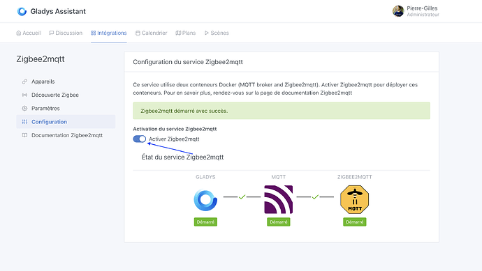

The goal of this integration in its current operation is to make the very existence of Zigbee2mqtt completely forgotten.
For the user, it’s just an integration that allows them to connect their Zigbee devices.
The « technical » operation must be totally invisible, and the integration must be stable for years, without interruption.
By totally separating the « Zigbee » behavior from the MQTT integration, we properly isolate the Zigbee integration, and if the user fiddles with the MQTT integration (adding a new broker, changing the MQTT password, etc…), it doesn’t break the Zigbee integration which runs on its own.

If you disable the integration in the interface, normally it cleans the containers properly.
Indeed if you touch the CLI, Gladys thinks the containers have crashed and therefore restarts them at the next startup.
