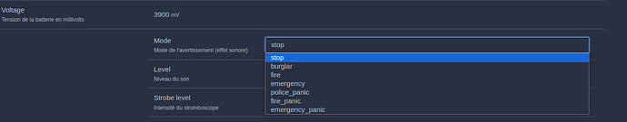

@Hizo Can you also not change the type of alarm tone from the zigbee2mqtt interface?
I’ll try as soon as I can to send the MQTT command manually with MQTT Explorer and see if it works better… To be continued
So I ordered another Zigbee dongle for my tests… it’ll be simpler and I’ll put my conbeeII key up for sale.
That triggers it if it’s not ‹ stop ›, but there’s no change in the alarm type.

On the zigbee2mqtt side you have to play with the expose « warning » parameters to activate the alarm. As I said these parameters have almost no effect
Only the mode works partially. That is to say all choices produce the same sound and « stop » does stop the siren.
The other parameters level, strobe level, strobe, strobe duty cycle and duration have no effect.

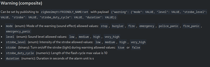

I haven’t made much progress on this topic this week, but I could use some help because I don’t see how to handle the expose that is of type composite. No problem with the other exposes but I’m a bit stuck on this one.
It therefore contains other exposes of type enum, binary, numeric
@pierre-gilles or @AlexTrovato if you could point me in the right direction
      "access":2,
      "features":
          "access":2,
          "description":"Mode of the warning (sound effect)",
          "label":"Mode",
          "name":"mode",
          "property":"mode",
          "type":"enum",
          "values":["stop","burglar","fire","emergency","police_panic","fire_panic","emergency_panic"]
          "access":2,
          "description":"Sound level",
          "label":"Level",
          "name":"level",
          "property":"level",
          "type":"enum",
          "values":["low","medium","high","very_high"]
          "access":2,
          "description":"Intensity of the strobe",
          "label":"Strobe level",
          "name":"strobe_level",
          "property":"strobe_level",
          "type":"enum",
          "access":2,
          "description":"Turn on/off the strobe (light) during warning",
          "label":"Strobe","name":"strobe",
          "property":"strobe",
          "type":"binary",
          "value_off":false,
          "value_on":true
          "access":2,
          "description":"Length of the flash cycle",
          "label":"Strobe duty cycle",
          "name":"strobe_duty_cycle",
          "property":"strobe_duty_cycle",
          "type":"numeric",
          "value_max":10,
          "value_min":0
          "access":2,
          "description":"Duration in seconds of the alarm",
          "label":"Duration",
          "name":"duration",
          "property":"duration",
          "type":"numeric",
          "unit":"s"
      "label":"Warning",
      "name":"warning",
      "property":"warning",
      "type":"composite"
Hi, as far as I remember, you can take inspiration from the « color » exposé (RGB…) which is also a composite.
If I turn on the computer this weekend I’ll give you more details.
I think I understood after looking into how the expose « color_xy » was formed.
Thanks.
EDIT: I managed to send the correct command from Gladys
