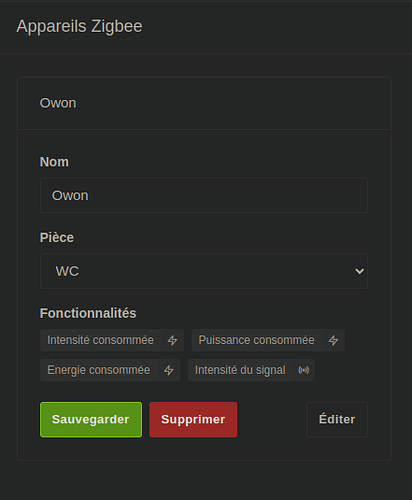

I’m writing something about the Owon PC321-Z and I notice that on Gladys it is only partially recognized — how can we add all of its functions?
Whereas in Zigbee2MQTT :

You need to submit a feature request for a developer to add them :+1:
Thanks for the feedback @McFlyPartages, I’ve converted this post into a feature request!

In this case, it will also be necessary to create new types of features, because we don’t handle « reactive_energy », etc.. I don’t even know what that is, I admit :sweat_smile:
@pierre-gilles
That corresponds to the energy consumed by old appliances like fridges and washing machines that have RC circuits with capacitors and that cause a phase shift; it is measured and billed in industrial settings with three-phase and not to private households, so…

If you need any doc/info about this device, don’t hesitate to ask me. I had taken care of adding some metrics, in particular the power factor:
I should be able to find the attribute IDs knowing that this device sends some non-standard metrics.
