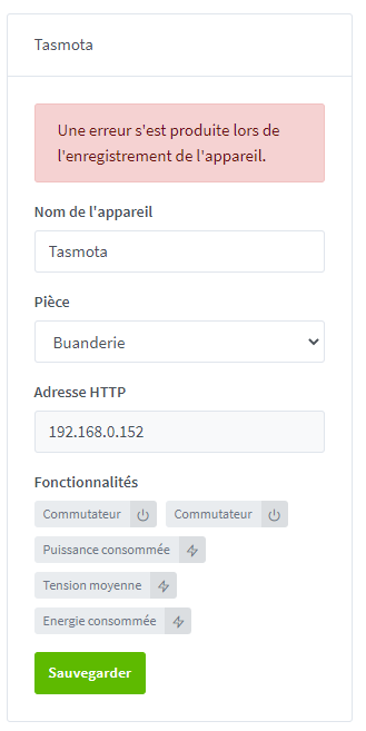

I have a Sonoff Dual R3 flashed with Tasmota that I want to add to Gladys but I can’t add it. Gladys always returns an error message.
Does anyone have any idea? Thanks in advance.
Do you happen to have another device with the same name?
I had another Tasmota device that I deleted. I also tried changing the name but without success.

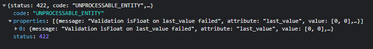

You want to see more details about the response in the Network tab of your browser’s « developer » mode, by looking at the response details.
As indicated I have the following error below
With the details
Thanks a lot. A bug has appeared!!!
I’ll ask a bit more of you, but can you also provide me with the request content?
With the entire « device »? So we can more quickly identify which feature reads a value « [0, 0] »

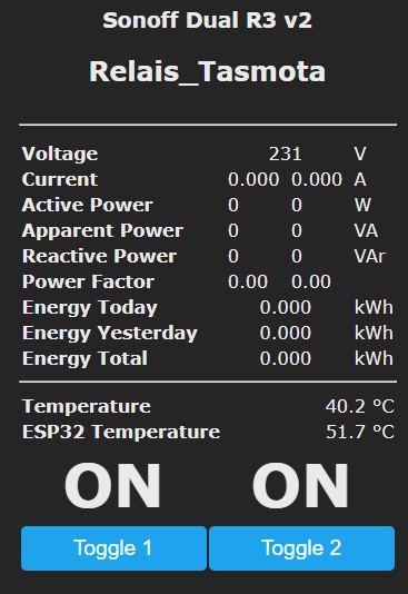

Below is the output of the STATUS8 and STATUS11 commands
09:59:39.403 MQT: stat/tasmota_DB3C40/STATUS = {"Status":{"Module":0,"DeviceName":"Relais_Tasmota","FriendlyName":["Relais_Tasmota1","Relais_Tasmota2"],"Topic":"tasmota_DB3C40","ButtonTopic":"0","Power":0,"PowerOnState":3,"LedState":1,"LedMask":"FFFF","SaveData":1,"SaveState":1,"SwitchTopic":"0","SwitchMode":[0,0,0,0,0,0,0,0,0,0,0,0,0,0,0,0,0,0,0,0,0,0,0,0,0,0,0,0],"ButtonRetain":0,"SwitchRetain":0,"SensorRetain":0,"PowerRetain":0,"InfoRetain":0,"StateRetain":0}}
09:59:39.525 MQT: stat/tasmota_DB3C40/STATUS11 = {"StatusSTS":{"Time":"2022-05-29T09:59:39","Uptime":"0T10:08:27","UptimeSec":36507,"Heap":150,"SleepMode":"Dynamic","Sleep":50,"LoadAvg":25,"MqttCount":1,"Berry":{"HeapUsed":3,"Objects":40},"POWER1":"OFF","POWER2":"OFF","Wifi":{"AP":1,"SSId":"freebox_WSMD71","BSSId":"DC:00:B0:95:F4:C0","Channel":6,"Mode":"11n","RSSI":74,"Signal":-63,"LinkCount":1,"Downtime":"0T00:00:03"}}}
09:59:39.781 MQT: stat/tasmota_DB3C40/STATUS8 = {"StatusSNS":{"Time":"2022-05-29T09:59:39","Switch1":"ON","Switch2":"ON","ENERGY":{"TotalStartTime":"2022-02-22T19:49:31","Total":0.000,"Yesterday":0.000,"Today":0.000,"Power":[ 0, 0],"ApparentPower":[ 0, 0],"ReactivePower":[ 0, 0],"Factor":[0.00,0.00],"Voltage": 0,"Current":[0.000,0.000],"BL09XX":{"Temperature":34.5}},"ESP32":{"Temperature":50.0},"TempUnit":"C"}}
Well, no need for the request content, I can see the problem on the 3rd line.
With these lines, I’ll be able to reproduce the case locally and try to fix it.

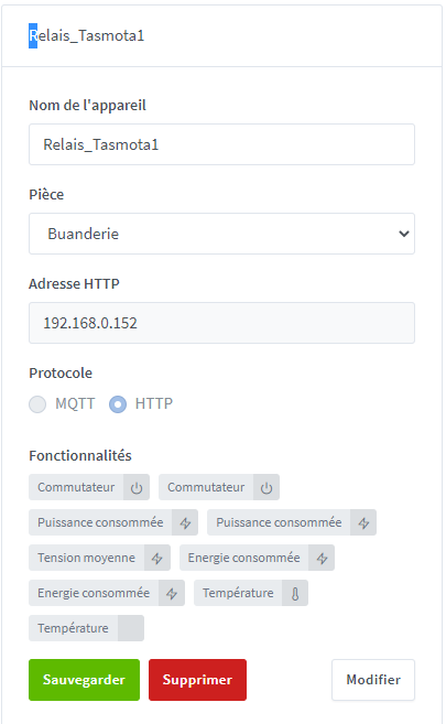

Good news, I was able to add my Sonoff Dual R3
I haven’t yet connected a load to the relays to see the power and energy. I’ll do it as soon as I have 5 minutes.

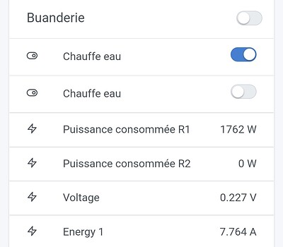

However the voltage value is not correct. 0.232V in Gladys instead of 232V.

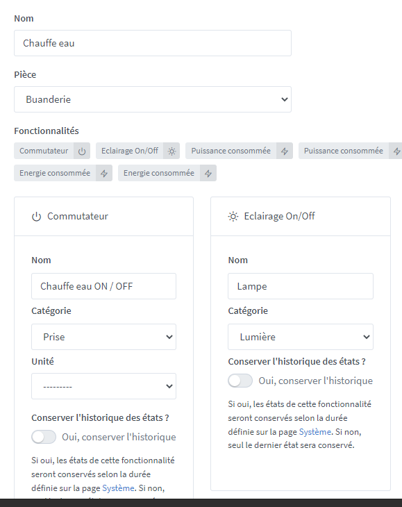

Thanks again for this fix, but regarding the names of the switches is anything planned?
Because I can change the name of each switch, but it’s not reflected on the dashboard
On the other hand, the names of other functions—for example, here I changed the power consumption—no problem, I can modify them and they’re displayed correctly on the dashboard.
