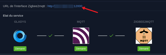

Everything is working fine, but I would like to access the Z2M URL given here:
I tested with two browsers, using the IP or the server name, but it times out every time.
I don’t know what’s going on. Thanks in advance.

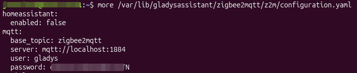

Did you set up Zigbee2mqtt from Gladys 100% without modifying the configuration on your disk, or did you make any changes? It’s possible that the IP recorded in Gladys is different from the IP configured in Zigbee2mqtt’s YAML config if you changed anything yourself :slight_smile:
Otherwise, it could also be a port issue if you’re accessing this on a particular network/from the internet. Don’t you have a firewall that you configured to block certain ports? (or, on the contrary, to allow nothing)
Are you on a local connection?
Yes, without modifying.
I don’t think I modified it but the configuration.yaml tells me this : :winking_face_with_tongue:
