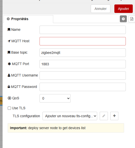

To configure your server you need to:
name: the name you want to see when you use (Gladys, or whatever you want).
mqtt host: localhost (if it’s on the same machine) or the physical address of your machine (192.168.1.150 for example). The first option, even on the same machine, sometimes doesn’t work. You need to use the address just in case.
Mqtt Username: Gladys (usually).

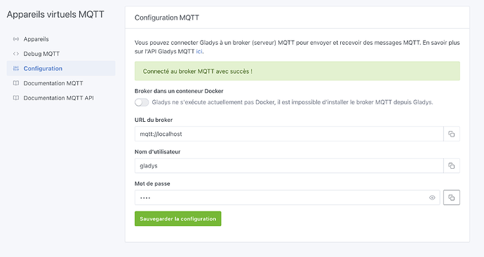

mqtt password: It’s in the configuration of the virtual mqtt devices in Gladys.
And then you click on add, it should work normally
To listen directly to Zigbee devices, there’s a small thing to change, after creating a new Mqtt server
The port: 1884 (instead of 1883).

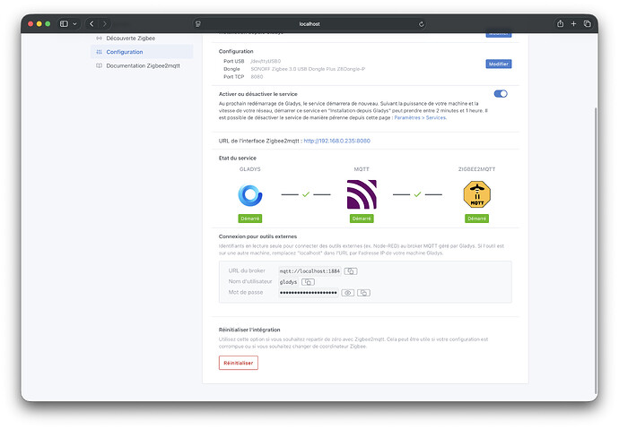

And for the password, you need to find it in your configuration folder via ssh. If you haven’t changed anything.
Send this command:
cat /var/lib/gladysassistant/zigbee2mqtt/mqtt/mosquitto.passwd
It should show you a file with the passwords.
If my memory serves me right, you need to retrieve the password that corresponds to the gladys line

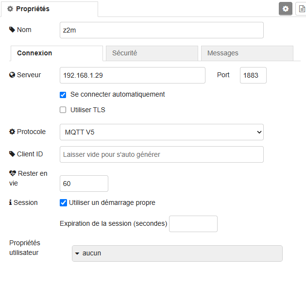

Thank you for your answers: I managed to create an MQTT server (in fact, I hadn’t chosen the right MQTT version, 5 in my case).

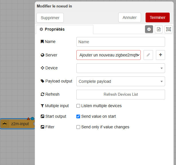

Now how do I get the list of Zigbee devices?
I changed the port to 1884, but in this case, it shows « MQTT Offline »

I haven’t tried the command (because I don’t know how to do it yet!) but I entered the password I got when I set up the MQTT integration in Gladys (which is visible in integration/MQTT/configuration). Is that the right one?
The MQTT server works fine, but I don’t know how to go further, especially to see the list of connected Zigbee devices.
The module in yellow corresponds to Zigbee2MQTT, and I see that it is not connecting. Maybe the problem is there?
To communicate with virtual devices, the correct password is the one you retrieve from the integration in Gladys
But for zigbee2mqtt, it’s different, as we don’t use the same mqtt server (Mosquito).
Both in the Mqtt server node and with the zigbee2mqtt node.
That’s why the port and password change

@Chris75, don’t worry, I’ll add the password in the interface, I think it’ll be useful to others too :slight_smile:
It will look like this:
I’ll deploy this later today :slight_smile:

If it’s possible to add the same copy-paste buttons for virtual Mqtt devices, that would be super practical. Especially for the password.
@Chris75 This is available in Gladys Assistant 4.81:
@dahut Yes, that can be added
Small note: these copy-paste buttons will only appear on Gladys Plus, as browsers do not expose the copy-paste functionality for local URLs.
Here you go:
This will be available in the next version of Gladys!
Thanks @all, it works, finally with the correct password for z2m, I finally have my list of devices
