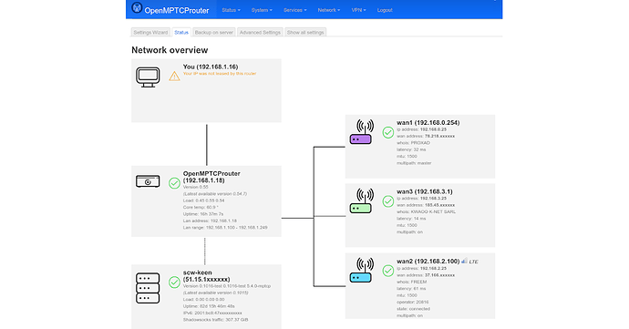

What I use at home: OpenMPTCProuter
Which can be used to aggregate internet accesses (ADSL / Fiber / 4G / …). At home, I installed it on a Raspberry Pi, and the service runs on an OVH VPS.
That way I can easily access my network from the outside :slight_smile:
If you prefer, you can use a dynamic DNS (dynDNS), where your local computer updates the IP on the DNS server.
Thanks @guim31 I tried this solution with OpenMPTCP which is indeed easy to implement, but I can’t do any aggregation as I only have one box and the installation on the RPI fails, (I couldn’t access the OpenMPTCP router at 192.168.100.1 to configure it). In your opinion, is the configuration possible with just the 4G box? Is this your case?
