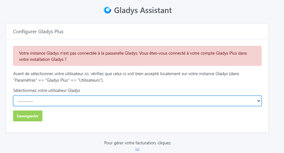

I had issues with my Free connection today.
Gladys is accessible locally so no problem, however each time I tried to reconnect with Gladys Plus (on my phone or PC) I had this message:
But in the dropdown I don’t see any available users.
To resolve the issue I have to:
  • connect locally
  • disconnect from Gladys Plus
  • reconnect to Gladys Plus
  • as a result I get a new key
  • I reauthorize my user
  • I access Gladys Plus again and this time my user appears in the list

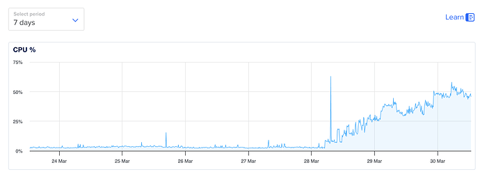

On the server side, I notice that some clients reconnect to Gladys a lot and that creates server load problems, so there seems to be a real issue :sweat_smile: (or someone is DoS-ing the server, but I doubt it — it coincides with the release of 4.56)
CPU load of the Gladys Plus load balancer:

Gradually, the more instances were upgraded to Gladys Assistant 4.56, the more often an instance would temporarily lose its connection, and those instances would enter an aggressive infinite reconnection loop.
I was receiving more and more emails, and I realized there was a problem!
