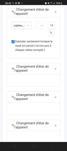

Actions not loading in a large scene
I don’t know if this is related, but if we have a lot of triggers or actions, they don’t load completely.

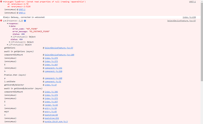

Can you check your browser’s console?
Here is what the console shows, and it also crashes Gladys, but not all the time.

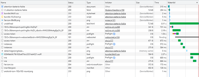

Have you seen the details of the requests that are returning errors? (Network tab?)

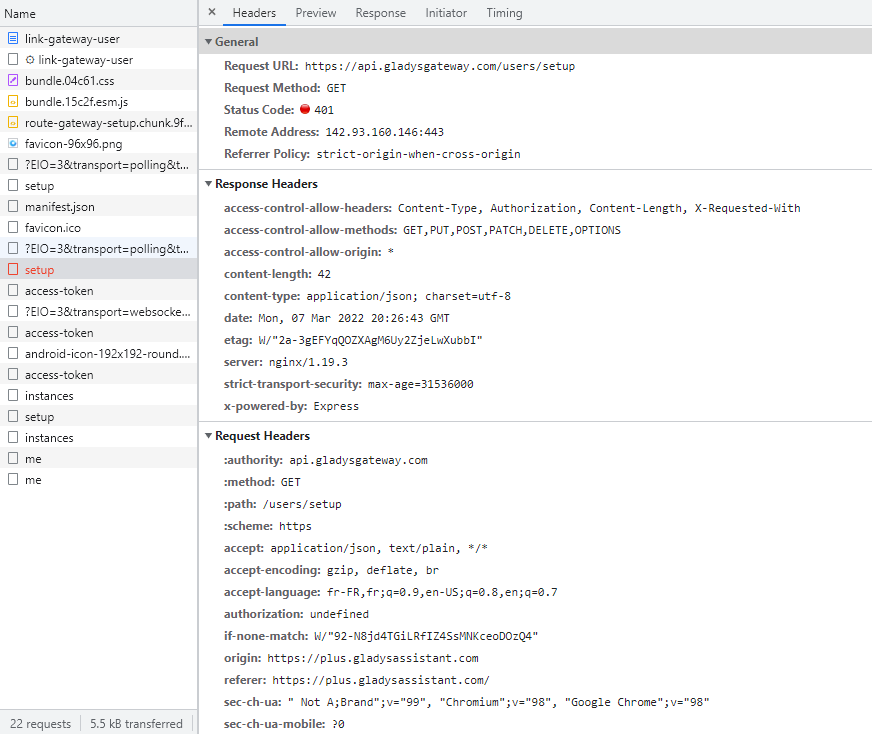

I’d be happy if you could send me the details of the local requests tonight.
You will find the requests in red in the Network tab, and you will open them to display the response.

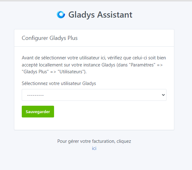

I tested it locally and there was no problem. It’s with Gladys Plus that it’s bugging.
When this happens, it takes me back to the configuration page.
in the console I have this:
