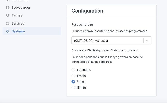

I fixed the bug and added more robust tests to ensure it doesn’t break again.
In the UI, there is now the possibility to modify the value in the settings:
