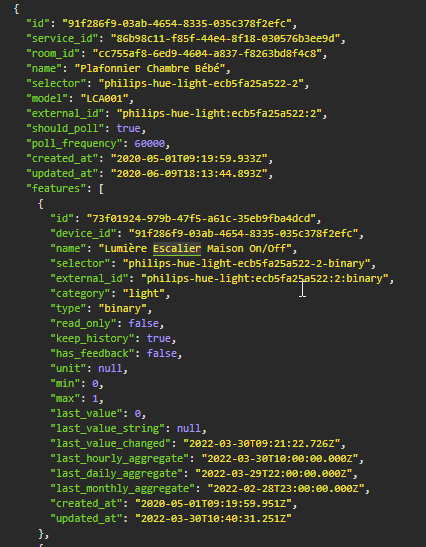

Would it be possible to add requests to the Rest API:
  • Retrieve the states of a feature from date to date. The goal would be to be able to retrieve data from a feature or a device once a day / week / month / year (example: energy consumed) and to be able to perform calculations in node red, the goal being to use the raw values and not the aggregations (in the same way as « /api/v1/device_feature/aggregated_states » but with all the values).
  • A « PATCH » route to be able to modify device and device_feature data.
    Concrete example, a Philips Hue bulb has changed its device name (bulb modified from room), but the feature name has remained that of the old location
In image
Another example, today it is impossible to modify the unit in the MQTT service once the feature is created. This would allow it to be done^^
Thanks for your answer if it’s possible^^
