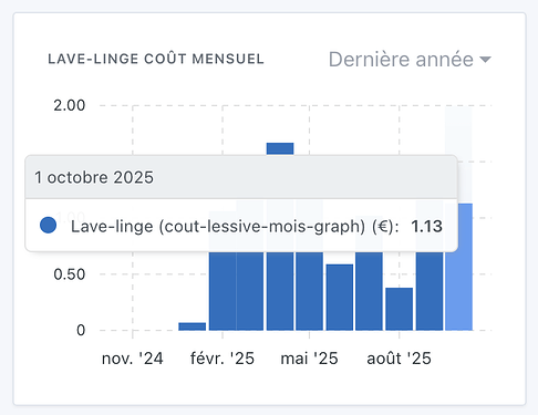

To keep the monthly cost and have a correct stats graph.
If you calculate on 01/11/25 at 00:00, then the cost will be allocated to the month of November. But we want the cost for the month of October in the charts, hence the calculation on 31/10/25 at 23:59, for example.
In my case, I’m on the 1st of the month because I didn’t want to create too many scenes, but that skews the stats a bit and I have a one-month offset:
Normally I should have €1.13 for September’s consumption but I’m on October 1st, though that’s going to change :wink:
