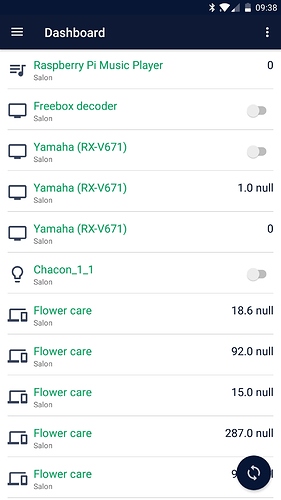

I have the same issue as @aiaalm, the refresh button caches a value and I can’t slide because there aren’t enough lines:
Additionally, the values are not the same in the dashboard and in the app…
Yes, I just saw that too.
How come the values are not the same? Did you synchronize? Because the view only synchronizes at startup and then only if you ask it to!

Yes, I restarted the app several times and even did refreshes, but there was a lag.
Now it’s fine…
@Pti_Nico the values displayed in the app are the same as those returned in your JSON!
How odd indeed :thinking:
