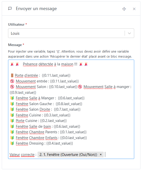

This morning I created a new scene for « Gladys starts » and I took the opportunity to update my « intrusion detection » scene.
But to my great surprise, my variables were turned into text and therefore no longer appear in the final message sent on Telegram.
The last line allows comparison of what should have been displayed:
I went through Gladys Plus and reloaded the page several times just in case. A trigger test also confirms that the variables here are in error.
Same behavior locally.
Wouldn’t you just need to add a space in the variable’s syntax? I find it surprising that it’s displayed like this :
{{0.11.lastvalue}}

You must have modified the scene order, each variable is identified by its position in the scene (0.1.1 are the coordinates of the variable in the scene)
If you change the order, it indeed re-creates the variables’ positions and breaks the functionality!
