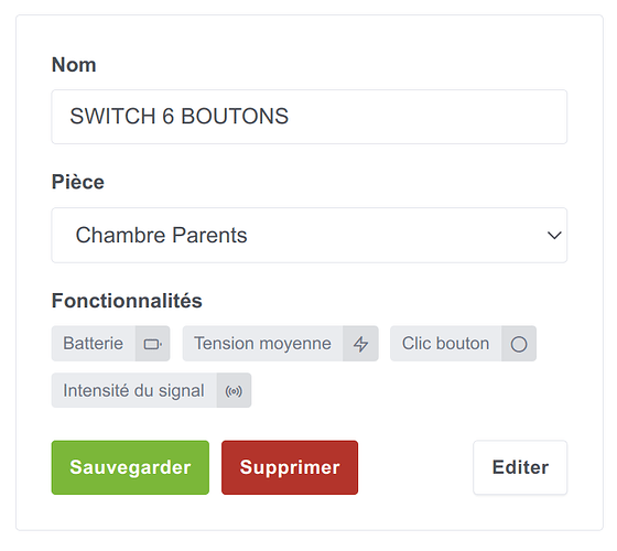

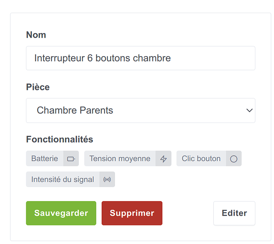

I also notice (but I don’t know if it was the case before) that I see duplicates in some of my devices:
My infamous switch (which behaves erratically)
In Gladys I have it like this:
But I also have it like this: (maybe an old name I had given it… I don’t even know)
Since I only have one 6-button switch, I can’t have two of them in Gladys.
How can I debug this? I remember having issues before when removing duplicate devices. It’s also happening with other switches.

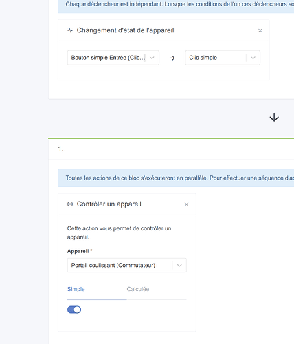

The thing is I’m sure of myself, I never created a scene that involves my gate and that switch. I have only one scene that links the gate, it’s with an Aqara push button (scene that works very well) :

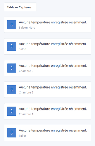

I don’t know if this comes from Z2MQTT but suddenly at 5:05 PM I lost all sensor readings:
Is this common?

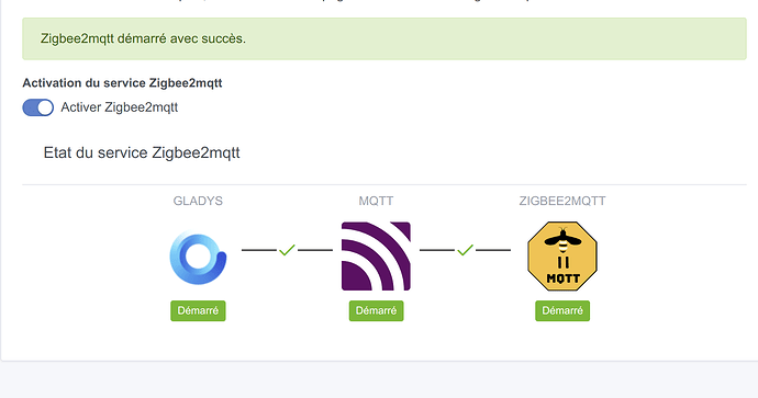

Latest addition, I’m trying to tinker a bit and I notice that even when zigbee2mqtt is stopped manually (via ssh) my configuration page still shows this:
Is that « normal »?
