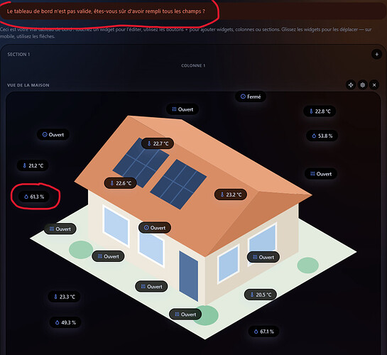

When I try to add a 21st pin, I can’t save the dashboard
(When I remove it, I can save it)
Hi @Chris75 ,
Thanks for the feedback and screenshots, and sorry for the delayed response!
Your 21st pin is nothing special: the “House View” widget is limited to 20 pins . The real bug is that the editor lets you place a 21st pin without saying anything. Then, when saving, Gladys refuses the dashboard with a generic message (“Are you sure you’ve filled in all the fields?”) that doesn’t help at all in understanding the problem.
I’ve opened a GitHub issue to fix it: #3357
The idea is to raise the limit and make sure the editor clearly warns you when you reach it, instead of blocking the save without explanation.
In the meantime, you can work around the problem in two ways:
split your values across two “House View” widgets (for example, one for temperatures and humidity, one for openings);
or display some of the values in a “Status Badges” widget.
