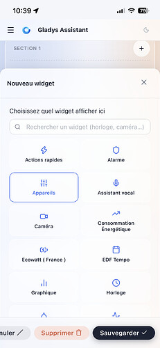

@pierre-gilles With v5, on my iPhone, when I edit a dashboard and want to add a widget, the widget selection screen appears but Gladys no longer responds: if I click on a widget name, it doesn’t add, if I click on cancel or save, the screen doesn’t close…
I’m stuck on this:
I don’t have this issue on my computer.

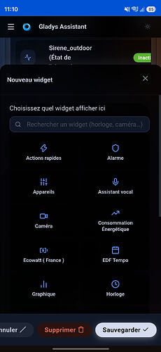

No issues on s26
However, the Cancel buttons, notably, overflow

Thanks for the report and the screenshot, it was decisive :folded_hands:
The detail that unlocked everything: on your screenshot, the « Devices » tile is framed in blue — this is the hover state that iOS leaves stuck after a tap. So your clicks were getting through, it’s not a touch area issue. It’s the interface that stopped redrawing.
The cause is more general than the widget selector: when a component raises an error during rendering, Preact (the display library of Gladys) leaves its rendering queue in a locked state, and nothing redraws afterward. The screen remains frozen exactly as is, buttons still take focus, but no action has a visible effect — until the page is reloaded. This matches exactly what you describe: the widget doesn’t add, Cancel and Save do nothing.
I reproduced the scenario in a WebKit browser sized for iPhone: it’s enough for a single widget to crash for the entire editor to die this way.

  • and the bottom action bar, which was overflowing the screen on phone: in French, « Cancel / Delete / Save » is 452 px wide for a 390 px screen, and as it’s right-aligned, the overflow was coming out from the left — that’s why we see « …nuler » cut in two on your screenshot. It now wraps and everything remains reachable.
